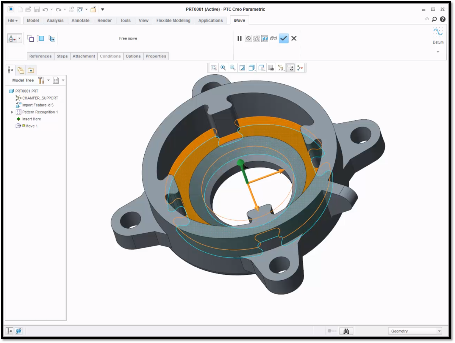

Now that Chamfers are supported, any chamfer geometry created with a PTC Creo Parametric 3.0 or later chamfer feature will automatically be handled by the system as a chamfer. Otherwise, for example with imported or legacy data, the system will extend and intersect the chamfer-like geometry as it would any other geometry. You can see how PTC Creo Parametric interacts with chamfer-like geometry by moving the geometry adjacent to the chamfer-like geometry. The chamfer-like geometry will extend and intersect the moved geometry.
Notice how the chamfer-like geometry is extended.

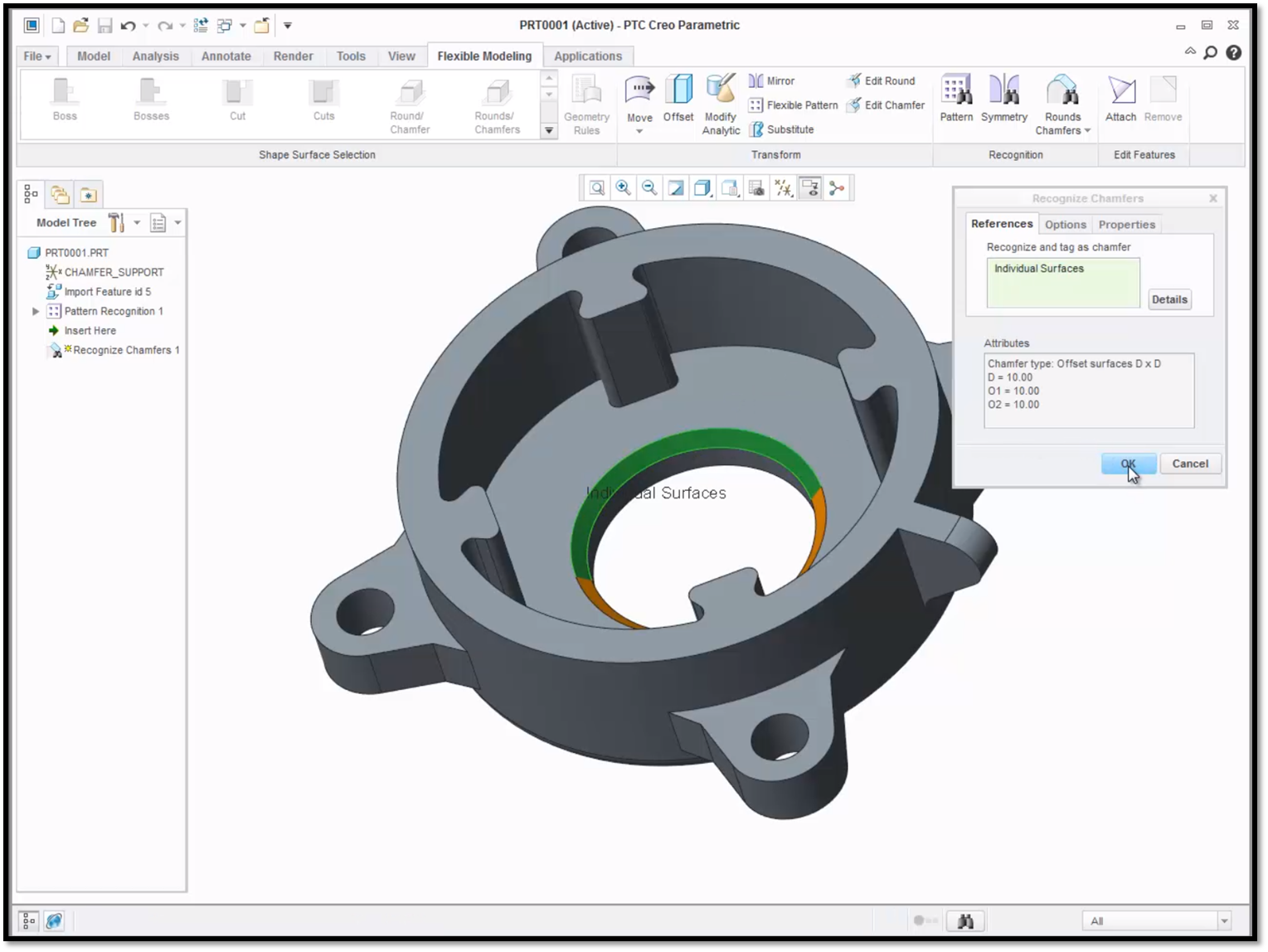

With PTC Creo Parametric 3.0, you have the ability to recognize and edit chamfer-like geometry from imported or legacy data. To instruct the system that chamfer-like geometry should be treated as a chamfer and not like regular geometry, use the Recognize Chamfer tool. To select the chamfers that should be recognized, select Recognize Chamfers from the Rounds Chamfers dropdown menu. Next, select your References and click OK. Using the Move feature, you can see how the system maintains the engineering intent of the chamfer. Similar to rounds, the system first removes the chamfer, executes the flexible modeling operation, and then recreates the chamfer at the end.
Here you can see the individual surfaces that were selected to be recognized as chamfers.

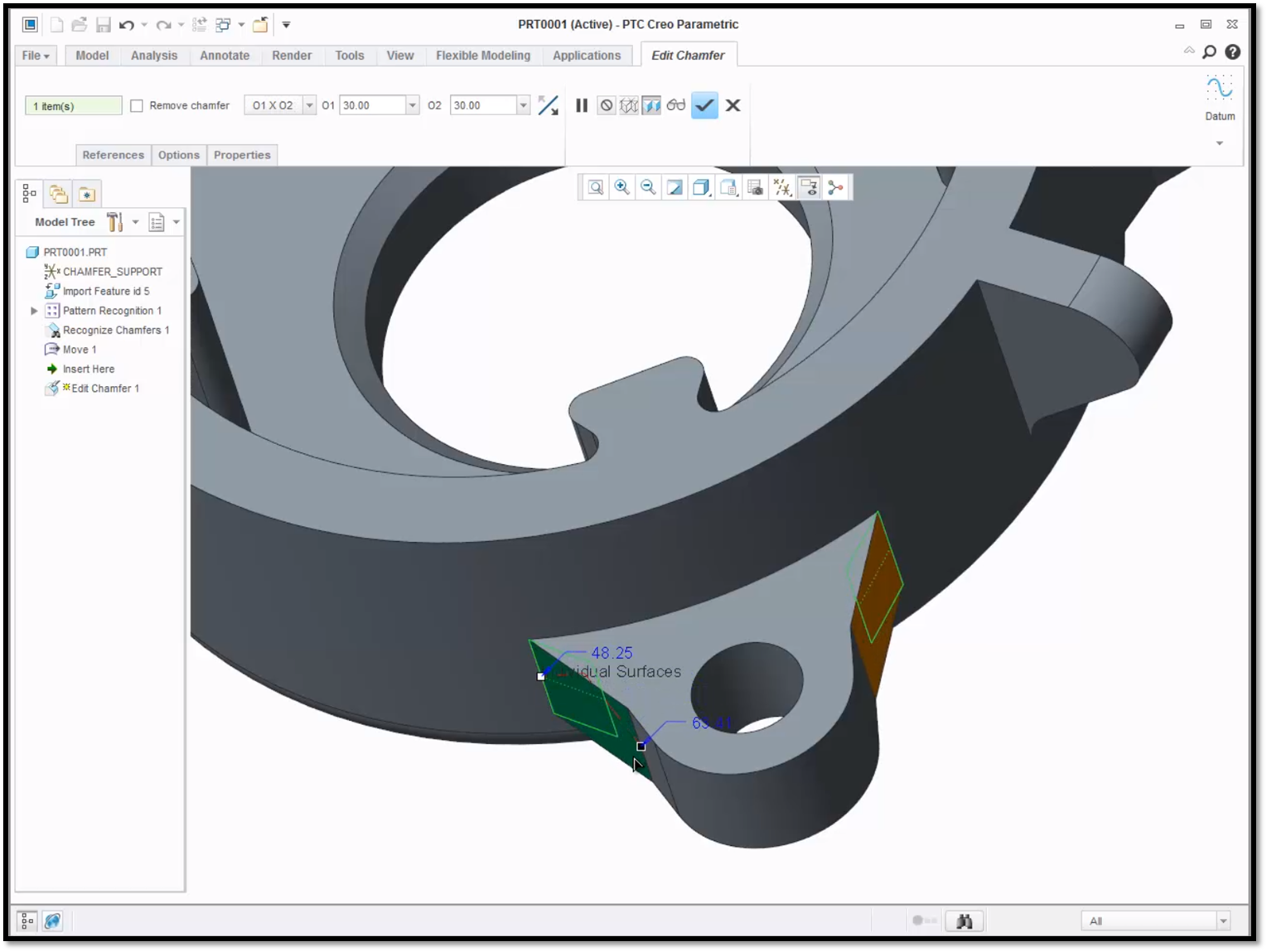

Chamfer and chamfer-like geometry can be edited with the Edit Chamfer tool. Similar to rounds, you have the option to remove the chamfer or change its size and dimension scheme. To do so, select the Edit Chamfer tool and check the Remove Chamfer checkbox or change the dimensions scheme or values associated with the chamfer.
In this example, the chamfer was modified using the dimension drag handles.

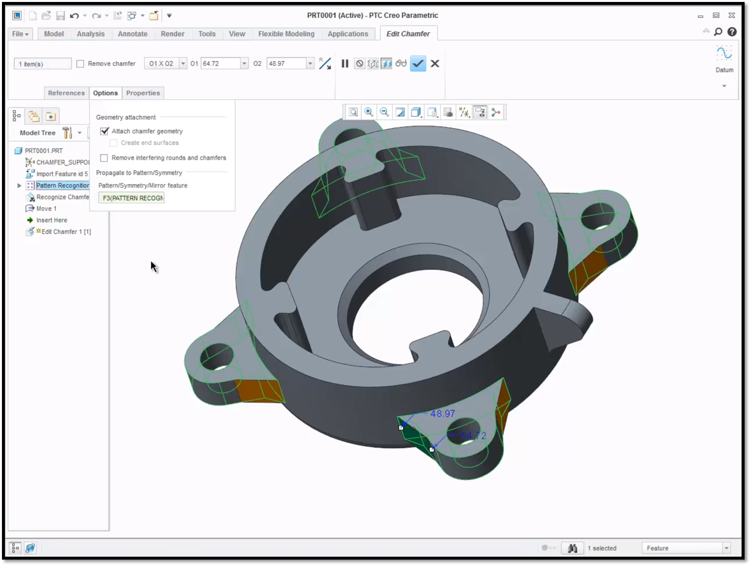

When you are editing chamfers on a pattern, you can make the changes to one pattern member, and then quickly propagate the changes to other pattern members. To do so, open the Options tab. Click the dialogue box below Pattern/Symmetry/Mirror feature and select a Pattern or Pattern Recognition feature within the Model Tree. The system will propagate the chamfer edits to the other members of the pattern.
Here, you can see the system propagating the changes to other members of the pattern.
