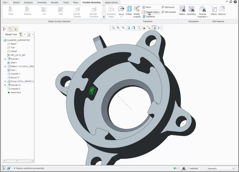

The PTC Creo Flexible Modeling Extension (FMX), allows you to leverage the ease and speed of direct modeling within PTC Creo Parametric. With PTC Creo 3.0, a Flexible Pattern tool has been introduced for PTC Creo FMX, giving you access to new capabilities when creating patterns of geometry.  Don Breda, Product Manager at PTC, gives us a quick introductory overview of the tool:

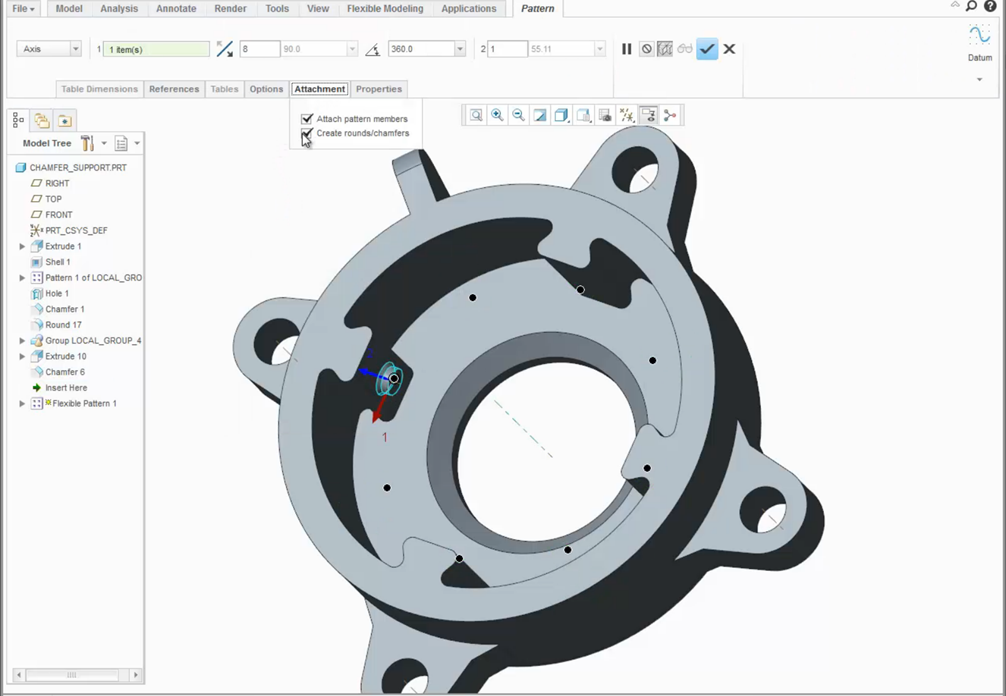

The Flexible Pattern tool allows you to leverage the round and chamfer handling capabilities of PTC Creo FMX while creating a pattern of geometry.
The flexible pattern tool available within the PTC Creo Flexible Modeling Extension
By default, the flexible pattern tool will remove any round or chamfer attachment geometry and extend the one-sided edges of the pattern geometry until it intersects solid geometry. Then, it will recreate the round or chamfer attachment geometry.
With the Attachment options, you can control whether or not the round or chamfer attachment geometry is recreated after it is removed. You can also control if the one sided edges are extended.
A look at the Attachment Options within the Flexible Pattern tool
Under References, there is an option which allows you to tell the system to treat attachment round and chamfer geometry the same as the rest of the pattern geometry. In this instance, they will not be removed and recreated. Furthermore, if the attachment option is checked, their one-sided surface edges will be extended.
A look at the final patterned geometry after using the flexible pattern tool
