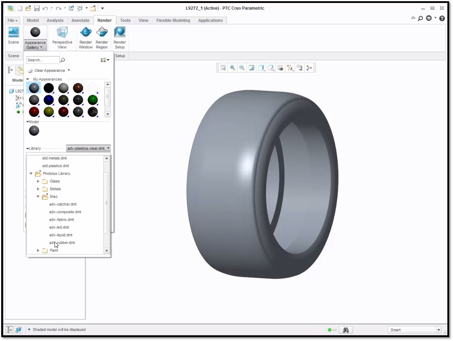

With PTC Creo 3.0 you can combine shading and reflections with detailed textures to make your model more realistic. When applying texture maps as a bump map you can see and control the result in the graphics area in real time. By beginning in Shading with Reflection mode you can visualize the effect of procedural bump maps such as Rough or Cast. You can then apply realistic textures and bump maps to the geometry. Begin by opening the model and assigning an appearance to it. Select the Render tab, open the Appearance Gallery, and select your appearance from the Library.
In this example, we applied the appearance of rubber for the tire.

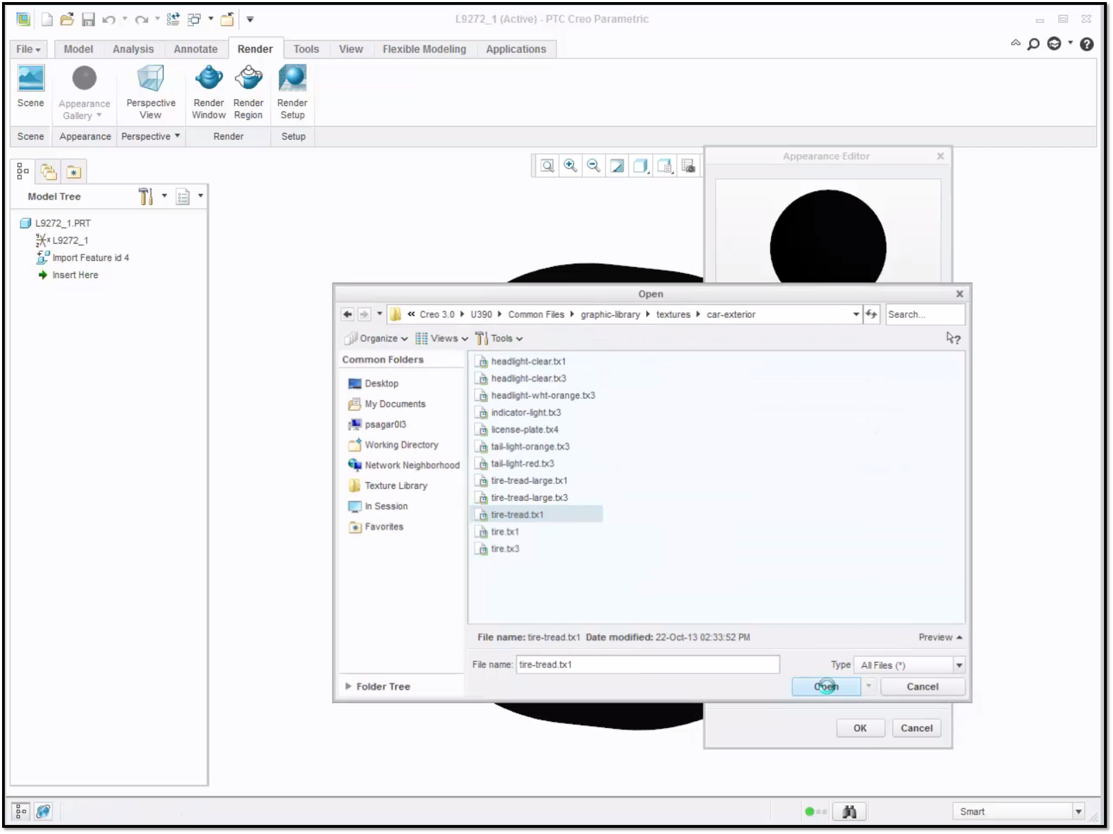

Next, assign a new appearance with a texture map to the selected surfaces of your model. Select the Render tab, open the Model, and assign a New appearance to the selected surfaces using the Appearance Editor.
Here we assign a new appearance with a texture map of a tire tread to the selected surfaces of the tire.

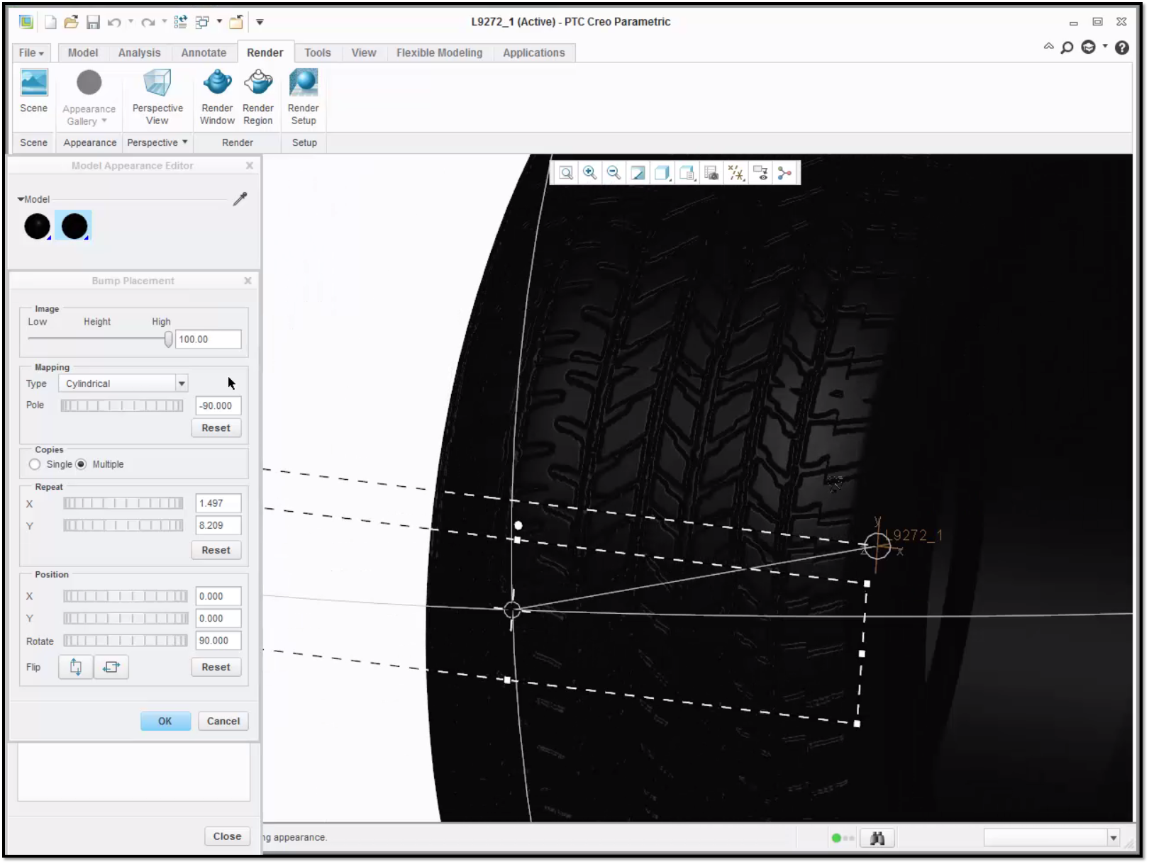

You can make adjustments to the bump map that are visible on the model, such as changing the scale, mapping type, and height.
In this model the mapping type was changed to cylindrical mapping.

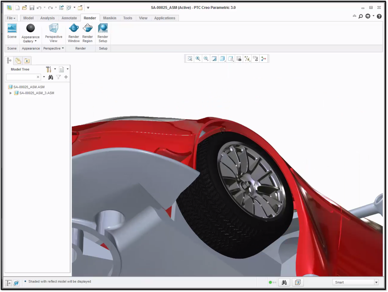

In the assembly you will see the model with the realistic bump mapping. If you select View, Shading with Reflections you see the model with the reflections.
Here you can see the tire and the tread with reflections.

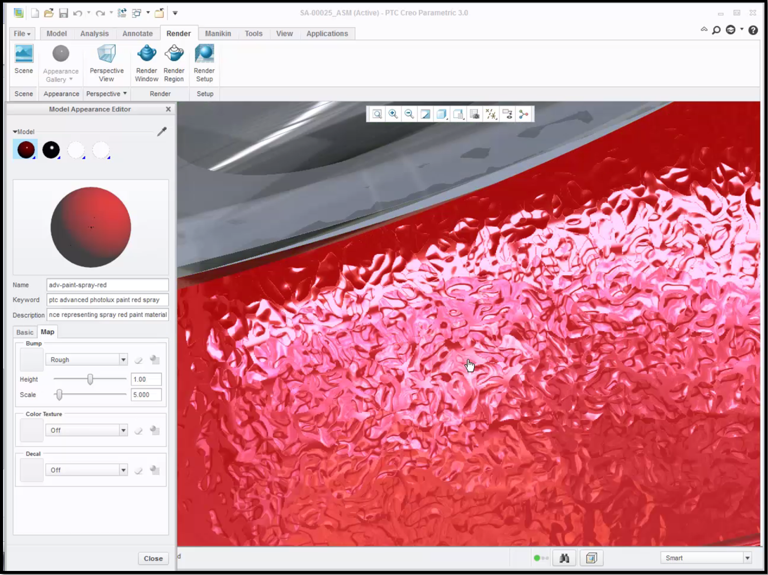

In addition to bump maps, you can also, alter the model by adding a rough procedural bump. Simply change the scale and size of the bump using the Model Appearance Editor to see the appearance on the model.
In this example you can see where a rough procedural bump added texture to the car body.

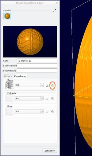

hmm, i ask myself where is the option to open the bump placement?
when i rotate my model in the viewer, the bump behaves not right.

  1. Image  – here you can choose an image and then define the exact placement and projection method, parametric, cylindrical, spherical or planar
  2. Rough, Cast, Cellular – We supply presets bump maps for rough, cast and cellular. These are calculated in 3D space and therefore have and need limited controls. You have the capability to alter the bump height, scale and rotate only
  3. Procedural image – this bump map is based upon view projection and therefore will change as you rotate the image, again there are controls to rotate and scale the image
For image based bump and textures you can alter the projection and access the controls. To do this you first need to apply the texture to the model and then pick the particular surface group that you want to edit. Once done you will have an edit placement icon next to the image.

11-Garnet
April 10, 2015
Well, thanks for the info but it does not work. the edit button is greyed out.
what have i done wrong?

Let's see if this helps. Try selecting the surface you want to edit the texture on. In the edit appearance dialog there is a color picker in the top corner. Select that, then select the appearance on the model to edit. The icon should now be available for editing.

what i did was: using the color picker, clicking at the modell shown in the modell editor, deleting the bump picture, putting it in again, doing this a couple of times and voila! somehow it was editable then. and also, the bump was attached to the surface and not moving while changing the view.

Graphical realism?  Are you sure? PTC Wildfire and then Creo has had pretty much the same render capability for over a decade, it was behind the curve at launch and I'm afraid compared to the likes of Keyshot the results are very far from "Graphical Realism" these days - just take a look at the underside of that red car and ask yourself - could I be looking at a real car?
If the answer is yes, you probably spend too long looking at a Creo screen.  Get Keyshot (or another dedicated renderer) and the Creo Plugin, they play nicely together.
