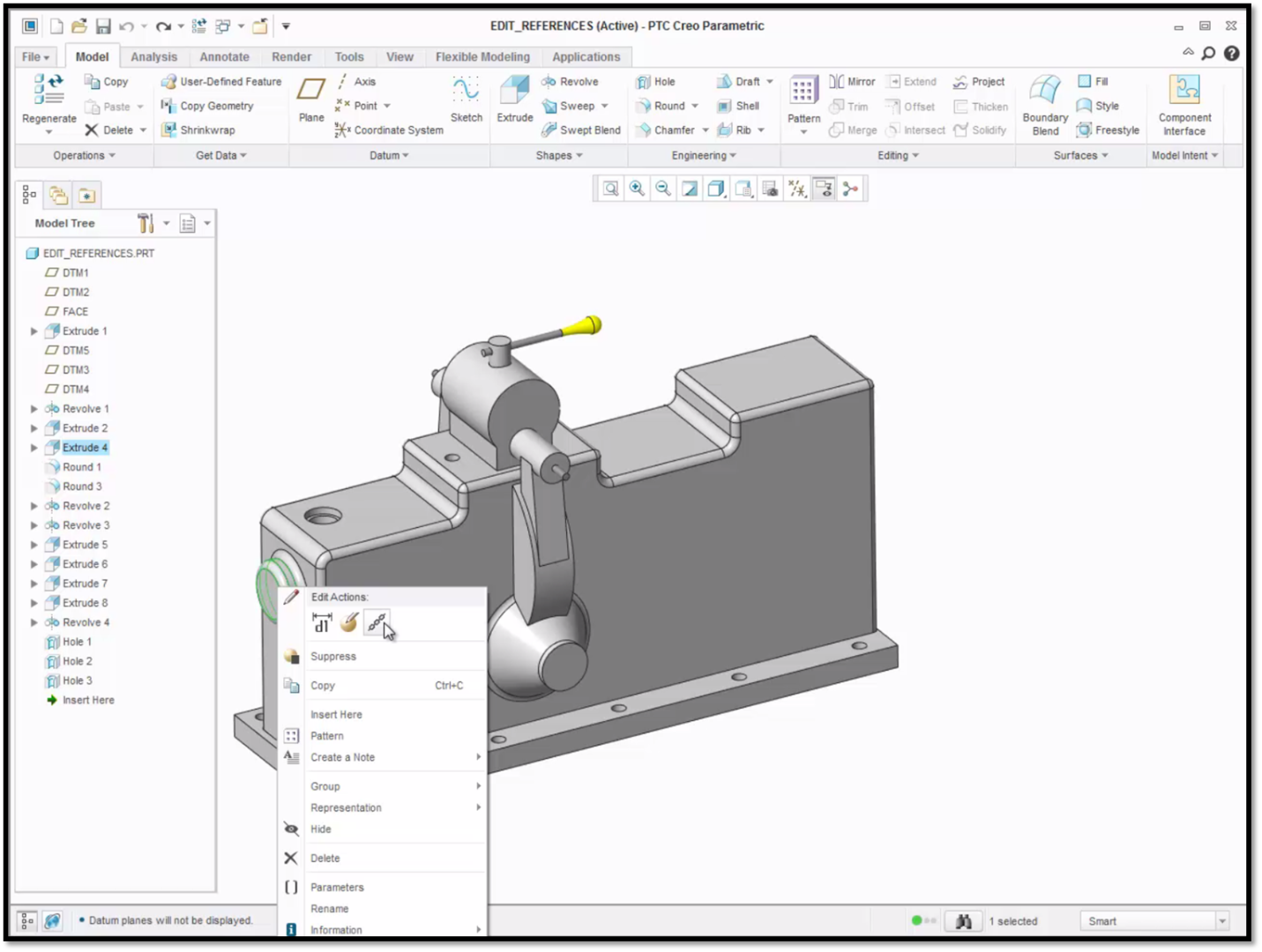

Whether you are editing references used for feature creation or replacing references for all downstream children, the workflows are now more intuitive, more flexible, and more powerful. Editing references allows you to change the references that are used to create one or more features. Begin by right clicking a feature on your model and selecting the icon that looks like a chain link to open the Edit References dialogue box. Select the Reference that you intend to edit.  Click Roll To in the Child handling section of the dialogue box to update the reference for all downstream children.
Click the icon that looks like a chain link to open the Edit References dialogue box.

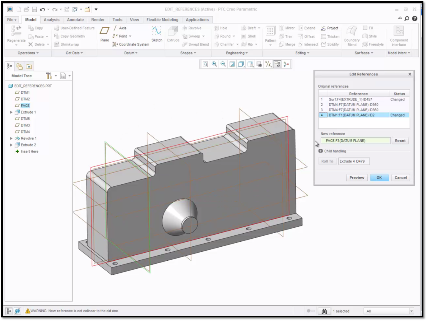

Click the Axis View icon on the toolbar to select the view you prefer. Plane Display was the view chosen for this example. A new user interface clearly shows you the list of original references used by the feature or features and allows you to change them. You can also roll the model to just before your earliest affected feature and preview the results of your change. After making changes to the references, select Preview, then OK from the Edit References dialogue box. If a Regeneration Failure dialogue box appears, select OK.
Here you can see the changes made to Reference #4.

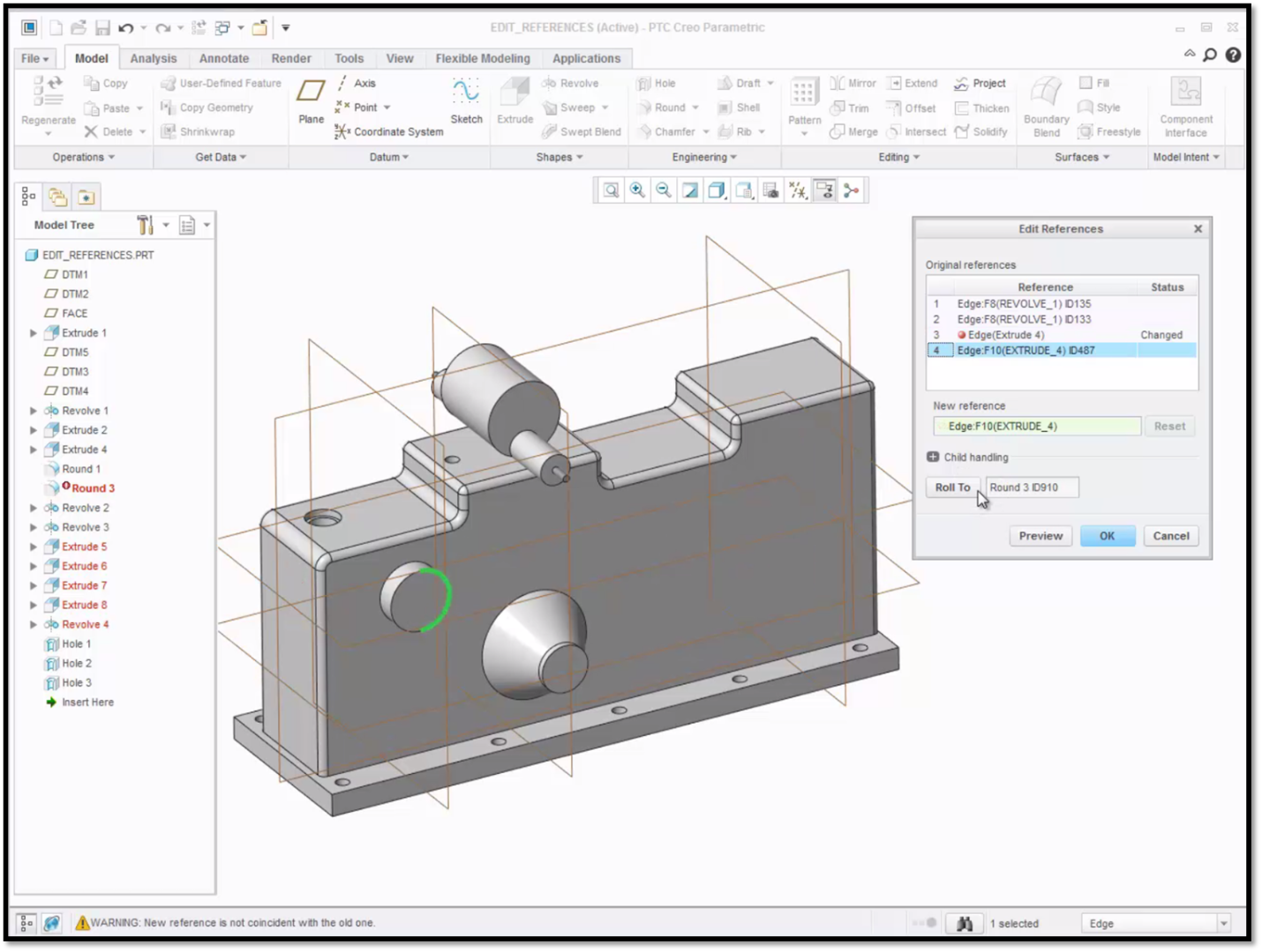

Open the Edit References Dialogue box again to see the original references. Missing references and their last regenerated location are now shown in red. You can use the last location shown on the model to help you select an appropriate replacement reference. Click Roll To to push the changes to the downstream children, then Preview, then OK.
Here you can see that the missing reference was moved and is now green.

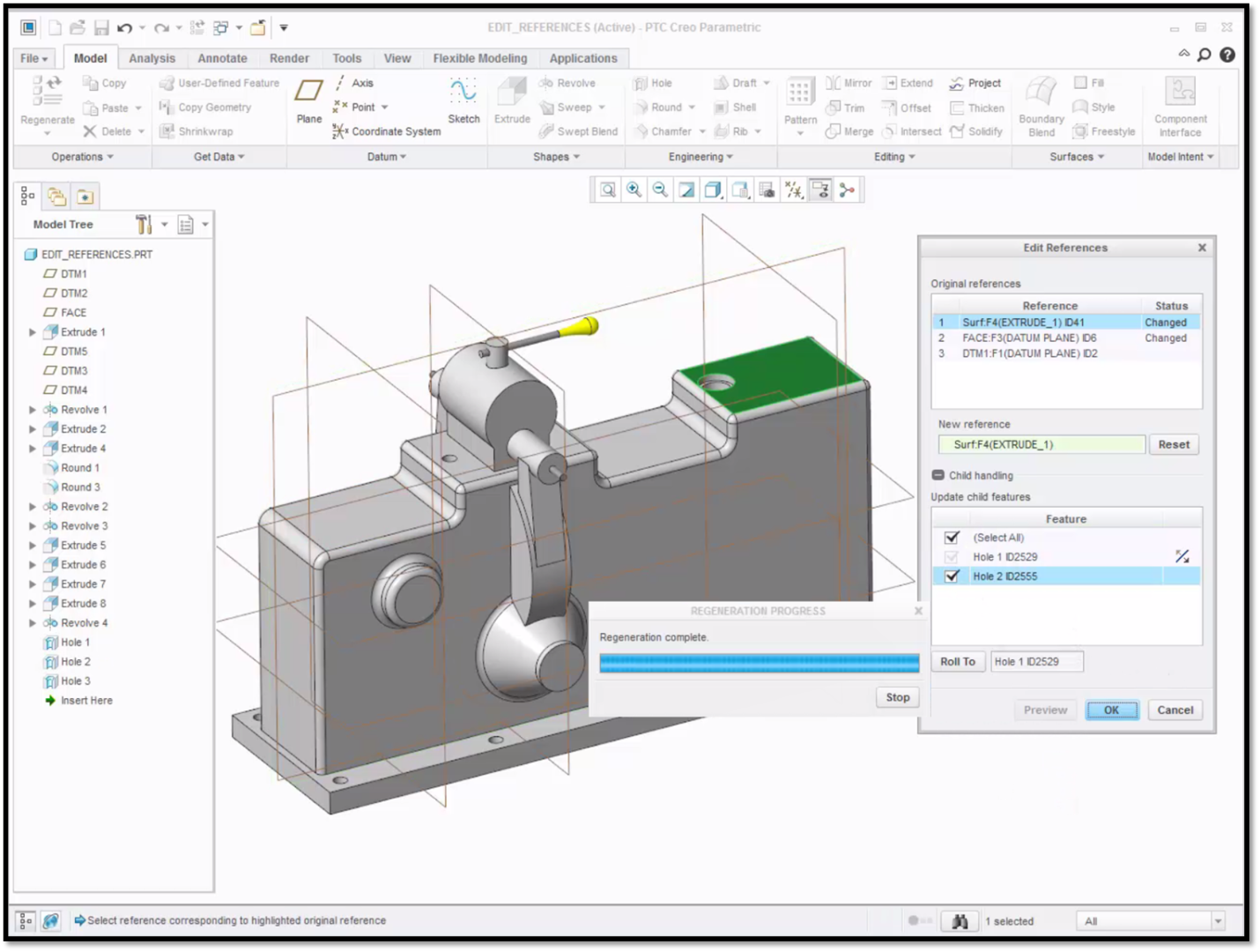

The optional Child handling section allows you to control of the features that were children of the existing references. As you assign new references to the features, you can flip the direction of the feature creation. To do so, select another feature and re-open the Edit References dialogue box.  Expand the Child handling section and select Preview. Now you can use the icon with two arrows to flip a feature.
Here you can see that we have the option to flip Hole 1 ID2529.

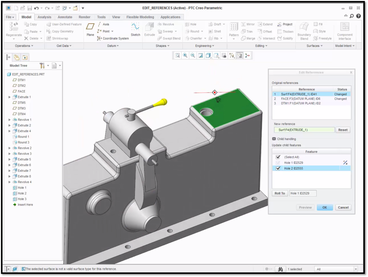

You also have the option to apply that same new reference to other children of the original reference. Navigate to another reference in the Original References section. Select the feature that you want to change and click Preview. Click OK to finalize the change.
Here you can see that Reference #1 was changed.

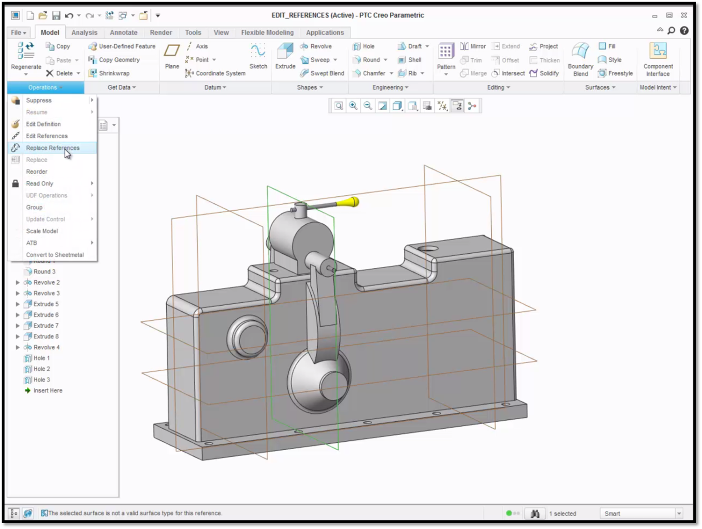

Replace References allows you to replace a reference for all children that use it. Open the Operations drop down menu and select Replace References. Click Roll To in the Replace References dialogue box to roll the model to the earliest affected feature, then preview the results of your change. If you don’t want to replace the reference for all children, then you can deselect those children.
Select Replace References from the Operations drop down menu to open the dialogue box.
