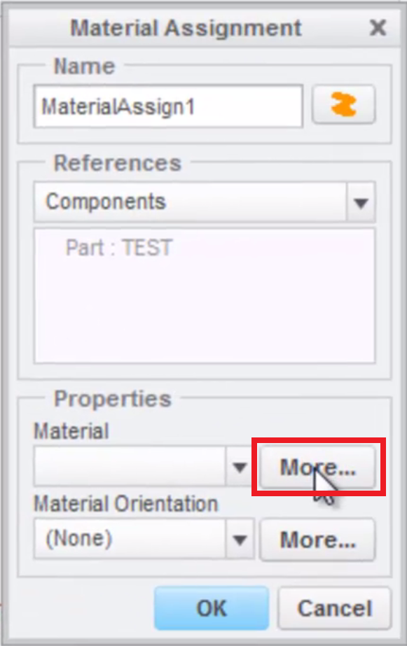

First, open the file you want to analyze. To do this, click Open and select the file on the File Open dialog box. Next, switch to Creo Simulate, then assign a material by clicking Material Assignment. The Material Assignment dialog box opens. In the Properties frame, click the More button next to the Materials list box. The Materials dialog box opens. Select a material, and then click the more button.png  button, then  OK.
Click OK on the Material Assignment dialog box.

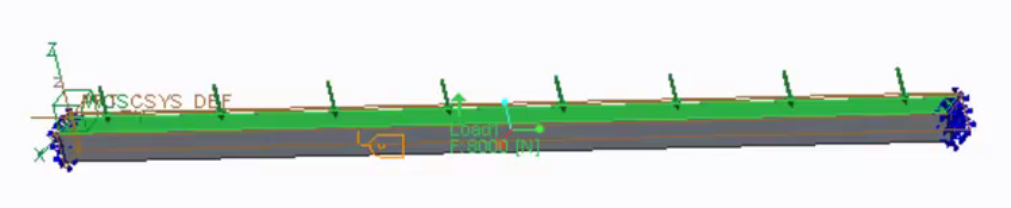

Next, you’ll apply constraints to your model. In the ribbon bar menu, click Displacement. The Constraint dialog box opens. On your model, select the end surfaces , and then click OK on the Constraint dialog.
Apply a load to the part. To do this, click Force/Moment from the ribbon bar menu. The Force/Moment Load dialog box opens. On your model, select the surface to which you want to apply the load. On the dialog box, make edits in the Force frame in order to apply a certain force to the surface. Click OK to apply the force.
A downward force was applied on this part.

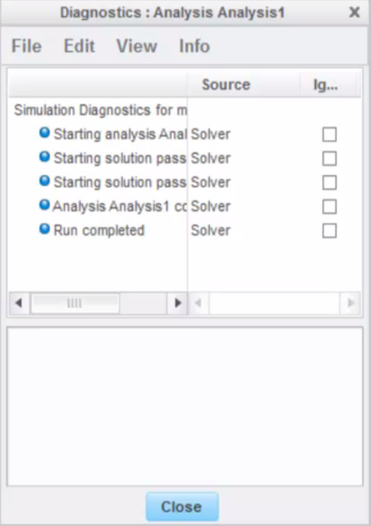

The Diagnostics: Analysis dialog (shown below) shows whether there were any errors in running the analysis. Review the results and then click Close on the dialog.

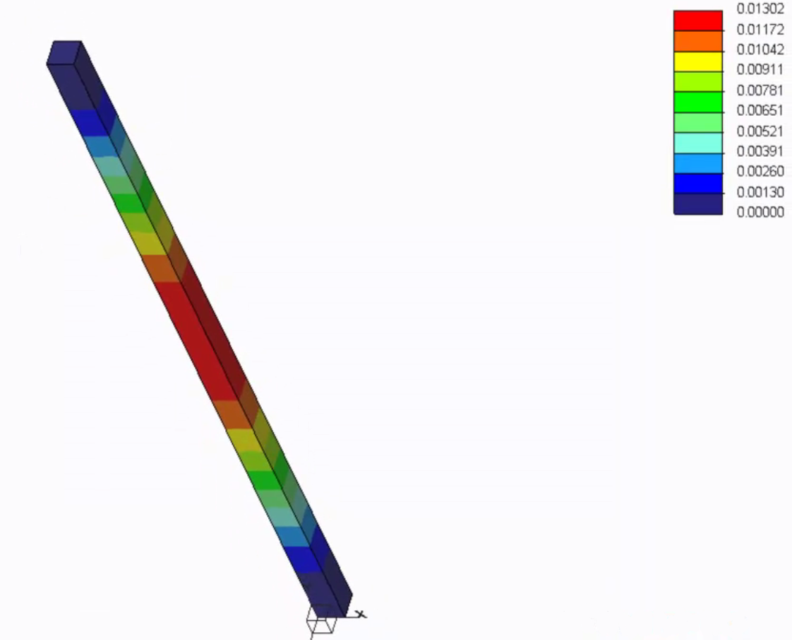

On the Analyses and Design Studies dialog, click the report icon report.png to Review results of a Design Study or Finite Element analysis. The Result Window Definition dialog opens. You can display Stress, Displacement or others in the Quantity tab. For this example, click Displacement, and then click the OK and Show button.
As expected, in this example, the middle of the beam was where it displaced the most. A color scale appears on the right side of the analysis, identifying the displacement range.

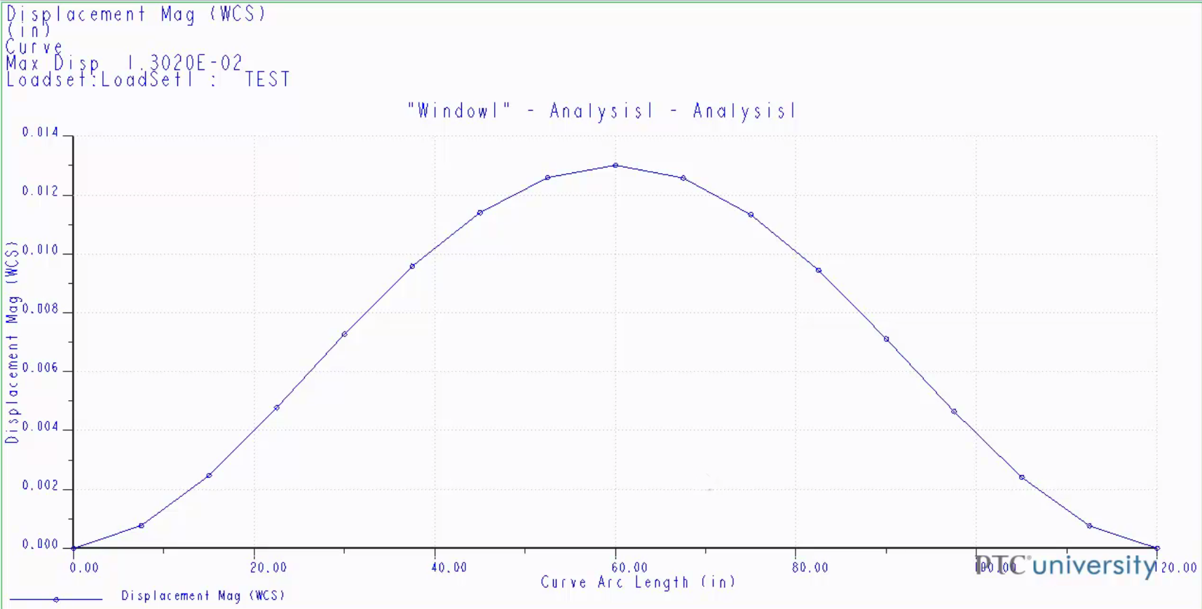

If you want to view the results as a graph, click the icon that looks like a paper and pencil to Edit the selected definition. The Result Window Definition dialog opens. Change the Display Type to Graph. In the Graph Location frame, click the cursor button to define the curve that you want to use as a measure. On your model, select the curve you want to measure. Click OK on the Select dialog. Click OK on the Information dialog. Click OK and Show on the Result Window Definition dialog.
The graph shows that the center of the beam has the most displacement
