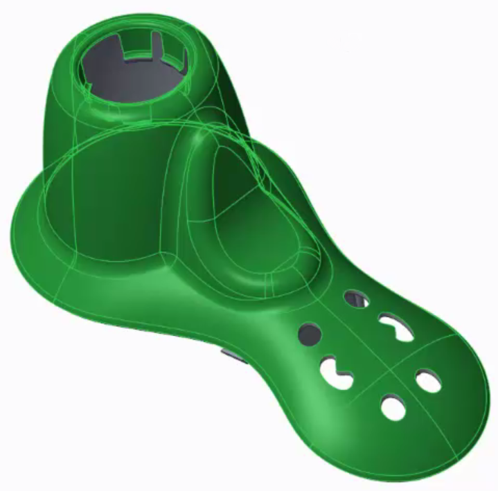

First, we will create a quilt surface on the reference part, and then that will be used in the mold assembly. To create the quilt surface, select a surface and then right-click and select the Tangent Surfaces option. This selects the outer surfaces of the model.
Image: The Tangent Surfaces option automatically causes the outer surfaces of the model to be selected.

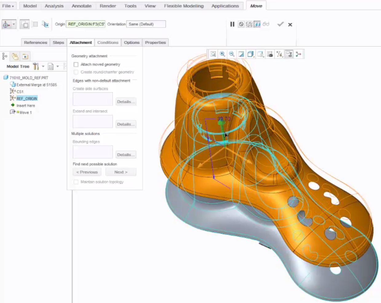

Next, to duplicate the selected surface using the Flexible Modeling > Move function. On the Attachment tab, clear Attach moved geometry. On the Move ribbon bar, click Origin Free (Default) and then select a reference coordinate system from the Model Tree.
Image: The 3D dragger (green arrow) can be used to move the duplicate surface.
On the Move ribbon bar, change the Tz (distance) value to zero (0.00). This ensures that the duplicate surface lies exactly on the model.
Then, on the Move ribbon bar, click the green check mark to apply and save the changes.

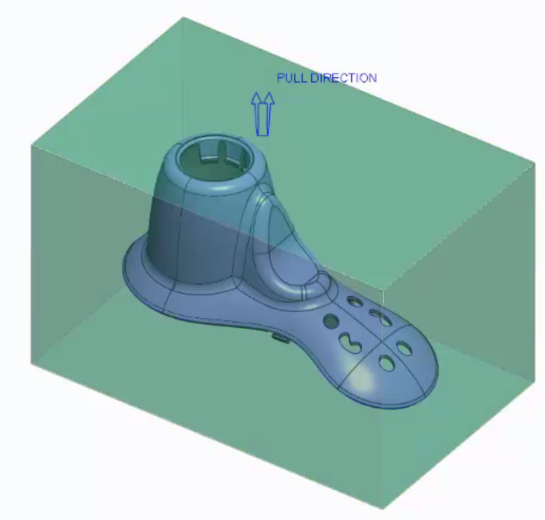

Now, the new surface can be used in a mold assembly, as shown below.
Image: The duplicate surface can be used easily in a mold assembly.
