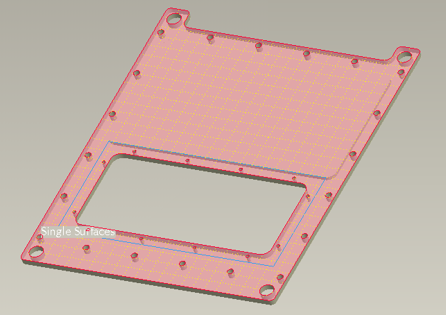

Hello to everyone:
I would like to see the same surface with different colors. Can I do this?
Attached is an example
Best answer by TomU
Nope. They have to be two separate, disconnected surfaces.

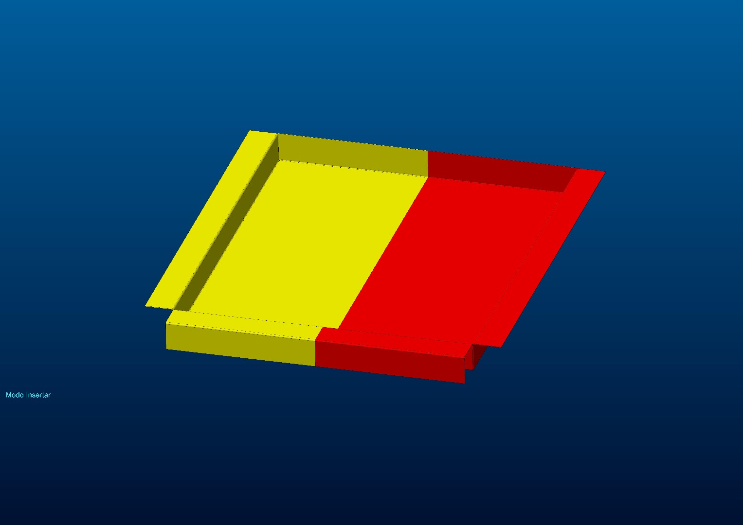

I've never done anything with them, but would it be possible to make a texture and apply it to the surface? Like the wood patterns, but with just two colors? I don't know enough about this stuff to know the mechanics of it, but it might be a method?
kdirth
April 29, 2015

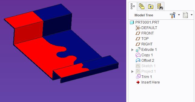

You can copy the surface you want a different color, offset a surface by a small amount (0.01), trim that surface to the shape you want and color it.

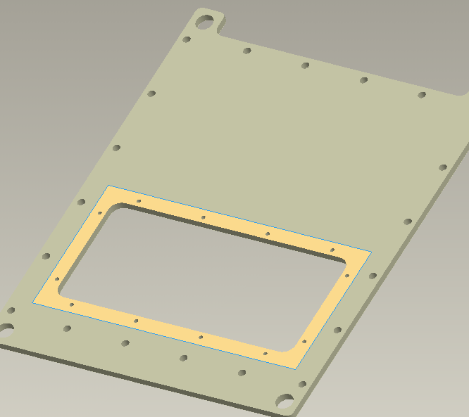

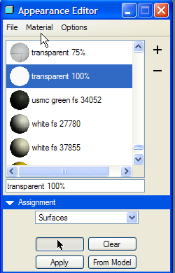

Man this Jive interface is killing me. Cut & paste below.
Step 1: Clear the Solid surface
Go to the Colors
Pick a 100% transparent color
Set category to surfaces
Pick on the surface of the model that will be split
Hit the Apply button
Step 2: Recreate Surfaces
The original surface is now transparent, the model is still solid and the top surface is still there.
Set the query filter to geometry
Pick on the “missing” surface
Use Edit > Copy (CTRL+C)
Use Edit > Paste (CTRL+C)
This initiates the surface copy dashboard
Use green check to finish new surface
Set the query filter to quilts
Pick on the “new” surface

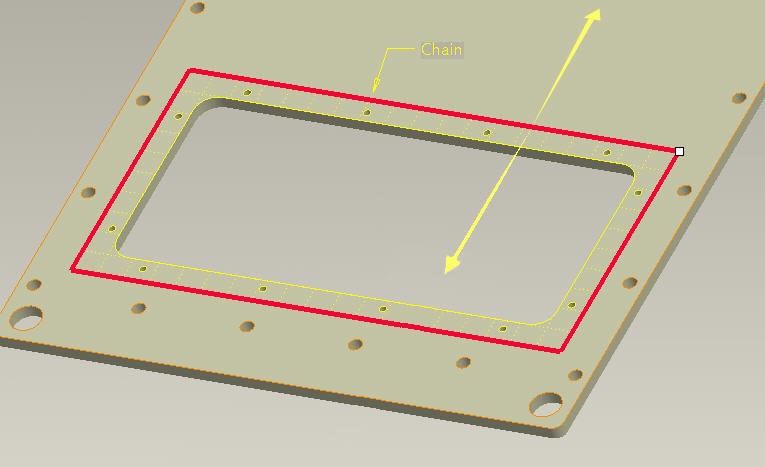

Use Edit > Trim
Create/use a sketch that is the color border
Yellow arrow and hatching indicate portion to keep
Use the switch direction button until arrow points both ways
Use green check to finish new surface trim
Step 3: Color the New Surfaces
Go to the Colors
Pick the desired color
Pick on the desired half of the split surface
Pick “Both” prompt
Repeat step. The only difference is to pick the other half of the trim surface
You may or may not need to change color of new surface
If it is the same as the original model color
