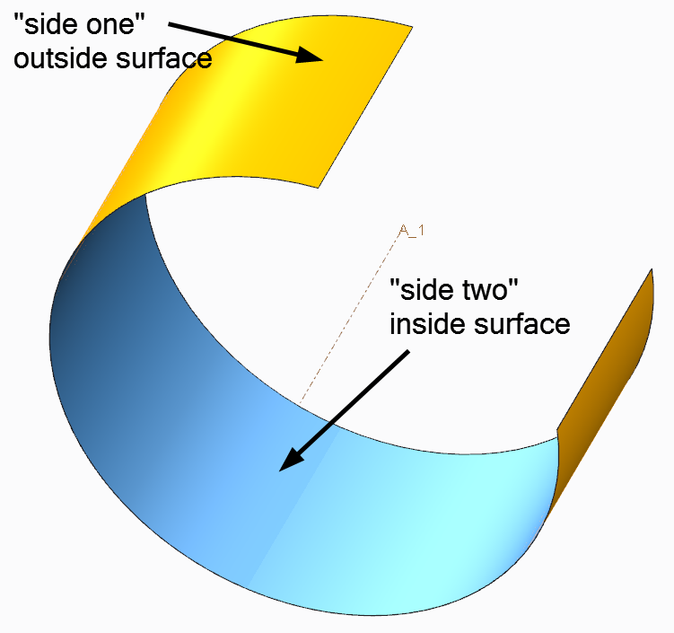

I use Creo 2.0.
Under ProE, you could apply the front and back with a different color on a surface (not a Solidsurface).
This was particularly useful for complex/detailed construction tasks.
How do I get this under Creo 2.0 ?
Stephan
Best answer by StephanLieker
Solution:
https://support.ptc.com/appserver/cs/view/case_solution.jsp?n=CS31449&lang=en
  1. single_side_surf_color yes
  2. The ALT key will act as a modifier and will show the direction arrow on the surface when the surface is ALT picked.

Welcome to the forum, Stephan.
You might be having a problem with your selection filter. You can easily select individual surfaces for appearance changes at part level and assembly levels. The only limitation is that if a surface is broken up but made as one feature, it will remain grouped unless you have the advanced surface model extension.
Try setting the selection filter to "geometry" and select the surface you want to change the color of.

Here is an example.
The colors "side one" and "side two" are different.
Stephan
October 27, 2014
Config option seems to be single_side_surf_color set to yes tho i still cant apply colour to one side of surface somehow.
October 27, 2014
Yep, surfaces are different.
StephanLieker7-BedrockAuthorAnswer

Solution:
