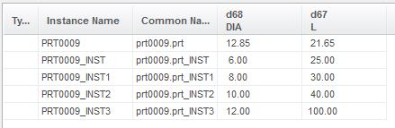

I think that what you are trying to do is fairly straight forward. Your drawing view will display the dimensions for arguments sake the length of the screw at 50.0mm, you want this to show 'L' or length so change the name of the dimension from d26 for example to L. then go to the display tab and enter as @s this will display L instead of 50.0
You will also see this in your models family table where the header has the original d26 and L to give you a clue as to what the column is displaying.

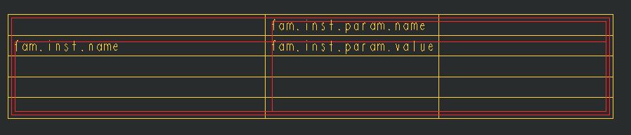

The harder part is probably where you need to learn how to report in repeat regions. Assuming you know very little about this I will try to give you a coincise idea of how to execute this. If you know more then I apologise in advance if it seems patronising.
Create a 2x2 table. You will need to define a Two-D repeat region. the first region will be the horizontal one. Click on repeat region/ add/two-D choose the first cell as row 2 column 1, the second cell will be row 2 column 2. then choose the vertical region row 1 column 2 and the second cell of that is row 2 column 2.
You then need to add the report parameters to drive the content. I have attached a screen shot of the content as it's a little too complicated to describe it all in one go. Note the 3 cells that are populated are the ones you defined in the Two-D repeat region.
If you've done this correctly the labels will be as you want and the values will be correct too all with nicely defined part numbers down the left.Capture-FT-model.JPGCapture-FT-definition.JPG

Yes, I know how to create a repeat region. The problem with a 2D repeat region is that you can't add additional text / parameters into the repeat region. 2D repeat regions also don't support tolerance display (which I need).
November 30, 2016

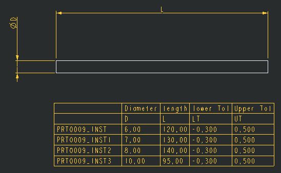

Hi Chris,
You could add header boxes before you define the two-d repeat region and I would consider creating an upper and lower tolerance parameter then adding these to the family table that way they can be reported on. You also should be able (i think) to add the relation to make the tolerances equal the parameter.Capturedrw.JPG
