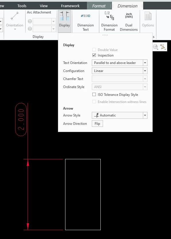

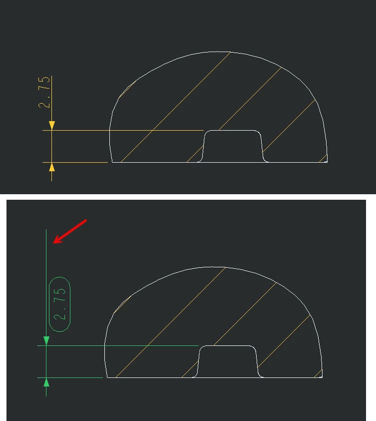

When I add an inspection circle to some dimensions, the dimension line extends more than required. In the following figure, this condition is shown, could anyone help me adjust it (PTC Creo 2)?

I am not able to reproduce that in Creo 9. Is it possible to share a simplified model with the issue?
Aug 11, 2024 9:50 AM UTC
Hi Chris,
I attached the drawing and drawing option settings. I wanted to have all units in mm in the drawing option and changed most of them but I don't know which option controls dimension line length in inspection mode.
Aug 12, 2024 5:39 AM UTC
Figured it out its "dim_text_gap", your settings have 5, I am using 1
