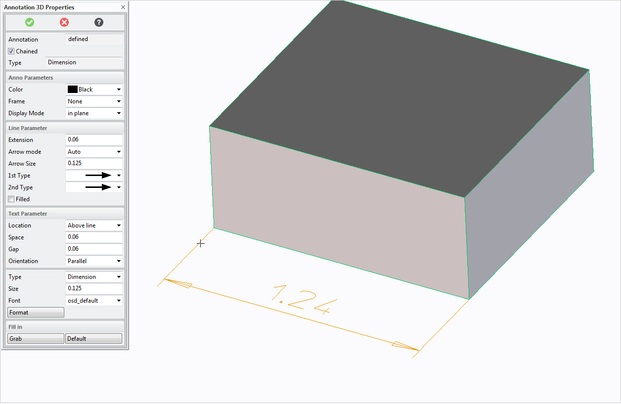

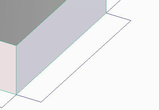

Ok, see my image, picture is a thousand words. I'm new. I searched discussions and help file, went through all the settings I could find. Well my dimensions are not showing? If I click on a dim line the pull arrows and the dim box pop up with the correct dim but in normal view they do not show. Any idea?
TIA
Best answer by GaryLinscheid
I believe you are in Creo Elements / Direct. I would guess that your arrow size and text size is set very small.

Thanks, after changing the size of them I can see them, but I have nothing to gage this against. trial and error I suppose.
