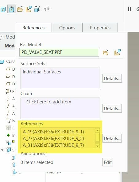

I have not tested this in Creo 7. Reading about the functionality when you create a part from a body an external copy geometry feature is created in the part. You can add references to a manually created ECG to include datum features, try to redefine the multibody generated ECG in a part and test if you can add datums from the master model to the extracted body part.
You should be able to add another ECG feature to include datums if it is not possible to add them to the auto generated ECG in the body part.

I have just confirmed that the method in my post above does work.
1) Open the part created from a body
2) Redefine the ext copy geom and select the references tab and activate the references collection box
3) Select the datum references as required from the master model
4) LMB "OK" to finish the feature
You will now have the desired datums from the master included in your part

Thanks for the insight, would you be able to explain where you found your redefine commands for the ECG? I tried doing similarly, but could only view the "Edit references" and "Reference Viewer" utilities with base ID references from the original multibody part - not the screen that would allow me to enable the reference collection box as you mentioned.
Much Appreciated!

This short video will explain it in detail. One caveat is that you must have a license that supports the top down design tools which includes copy geom features. If you do not have the required license then you will not be able to edit the definition of the ECG.
