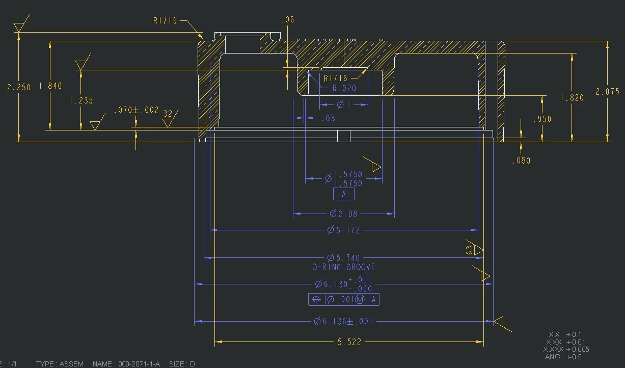

Hi Folks,
I'm trying to dimension an offset section in a drawing.
Shown dimensions show the correct value, but the leaders on the offset side are being shown away from the geometry they reference.
Created dimensions touch the geometry they reference, but they are showing the wrong value.
I have attached a file showing the affected dimensions in blue.
Any way to get this working??
July 13, 2013
Did you tried unfolded option. This should appears ok.
