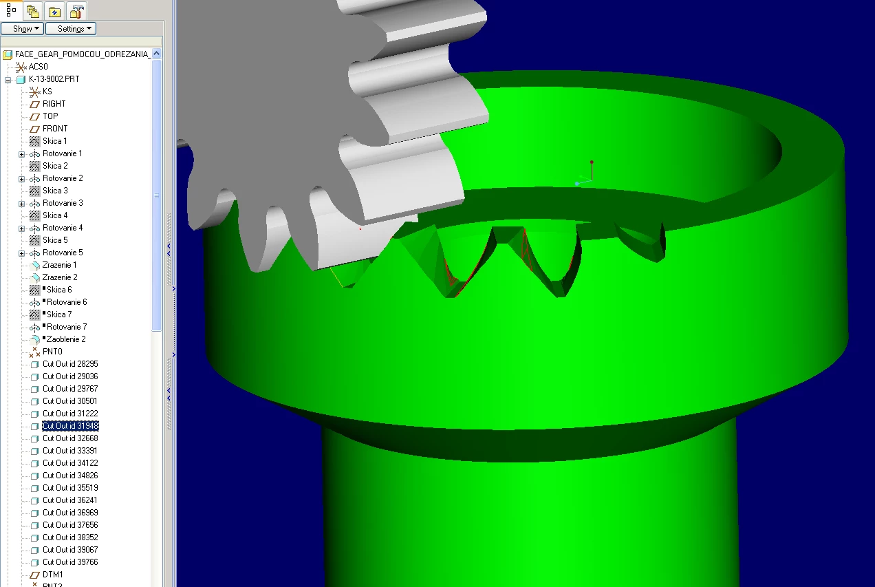

Hi.
My name is Jan.

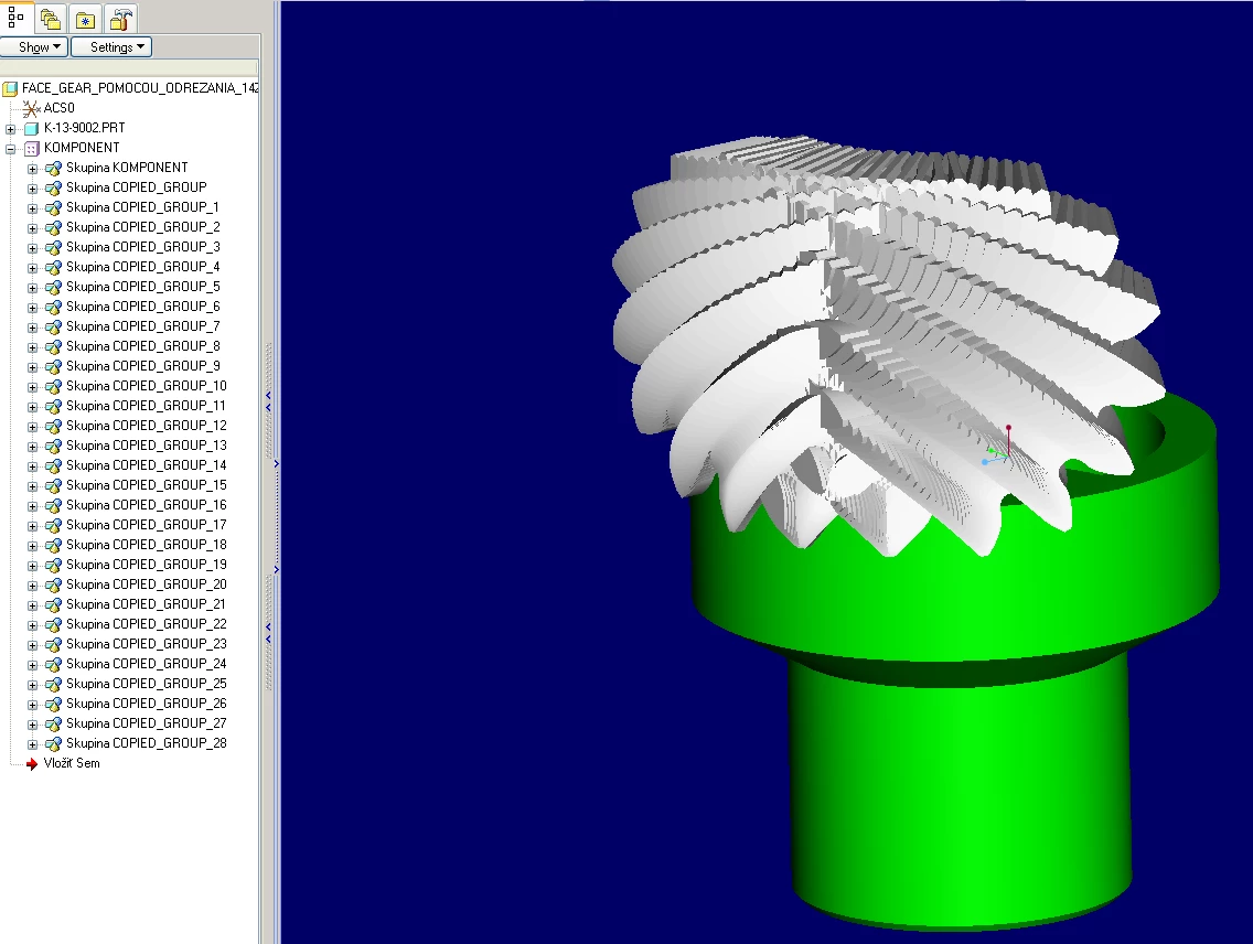

I try to generate geometry of face gear by easy way. Direct Digital Simulation. The principe is to pattern pinion part over face gear to simulate meshing. I used pattern to copy pinion part and than I done CutOuts between Face gear part and pinion part. But it is long and no correct process. I would like to do one CutOut and than apply Pattern on this CutOut. I don t able to find correct positioning. I want to use Pattern by Dimension, when I have to define two dimensions (angles) and inkrements to simulate motion by gear ratio. Is there any restrictions in using pattern and CutOut. Have you any experiencies with Direct Digital Simulation. Is it possible to do any continously CutOut to simulate meshing of gears?
Thank you for thinking about my problem.

For the gear you are trying to make, to the best of my knowledge (or recollection), it is treated like a rack gear tooth. They are typically straight faced and can be determined by the pinion's pitch diameter. They are also typically very narrow so they don't bind. Typically you find these in an erector set where these are stamped from flat stock. For any kind of serious duty, you would choose a bevel gear. The idea is that you would use these gears only in light duty applications so that a narrow tooth profile will suffice. Think of it as a narrow rack gear twisted into a circle.

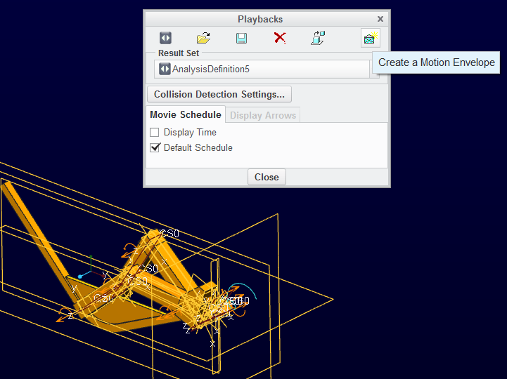

As for capturing profiles, have a look at the Mechanism tool. You can actually give a gear motion and make a solid from that motion envelope. Pretty neat stuff. If you create a mechanism analysis where the pinion rolled along it's pitch diameter around the face gear, you can get a pretty good profile of the motion path very similar to what you are doing now with the patterns.
Here is some info on this... have a look in the help files:
Create the motion envelope as the following steps:
  1. Create an assembly file and assemble related components with proper connections
  2. Applications > Mechanism
  3. Apply Servo Motor to the desired connection
  4. Create and run an analysis
  5. Analysis > Playback
  6. Click Creat a Motion Envelope icon
  7. Set Quality Level
  8. By default all the related components are selected
  9. Uncheck Ignore Skeletons and Ignore Quilts options if necessary
  10. Select Output Format
  11. Preview
  12. Create
  • ​Create trace curve as the following steps:
  1. Insert > Trace Curve
  2. Select a part as Paper Part
  3. Select a point or vertex as trace curve reference
  4. Select 2D or 3D as Curve type
  5. Select one analysis result from Result Set or open one existing analysis result
  6. Preview
  7. OK
So the bottom line is that the gear you are making is a special application. If the tooth thickness is significant, they will have a inward taper to them as you show. But again, typically these would be made as bevel gears at that point. Face gears are simply more forgiving with taper angle and other parameters that make them more universal.

I have not Mechanism modul, and I use old version of ProE Wildfire 2.
I know, that my way is not full correct, but I wanted to try it.
I have real problem to find manufacturer of special hobbing tool for Face gear (modul 0.28mm). Geometry of hobbing tool has to be created on base of pinion geometry, but I dint find any manufacturer of hobs, who understant this teory about face gears. All manufacturers asked for tooth geometry of face gear, but I think that for building of hob is necessary geometry of pinion, which I have.
I wanted to learn more about teeth shape of face gear.
In my aplication I can not use bevel gears becouse of technology and dimensions.
I need 3D model to create prototyp by milling proces.
