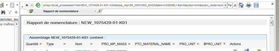

Hi all,
I want to show mass units in a BOM report like this one :
I've tried many parameters, but none are accessible in this report.

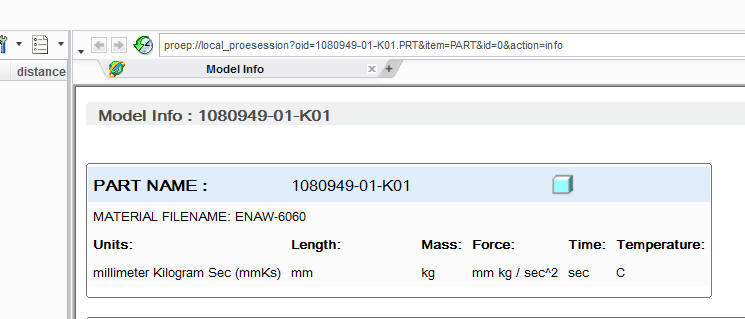

But I think it must be available somehow because it is displayed in the "model info" report :
I know I could do it by adding user defined parameters and relations, but I am using a lot of old parts that can't be modified.

Units are not parameters that are available. They only way to automate adding them as parameters to all of your models is to use Model Check. Even then if you go that approach, it is not parametric.
