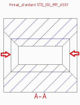

can anybody explain current Creo functionality ? My files created in CR3 M150 are attached.
If thread_standard  STD_ISO_IMP_ASSY detail option is set then start/end edge of cosmetic thread is displayed. Does anybody know, why ?

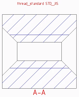

It is interesting that if thread_standard  STD_JIS detail option is set then start/end edge of cosmetic thread is NOT displayed.

Yep, Creo 2 does this.
I left it at the default ANSI version and the line ends of the cosmetic threads show.
Then changed the setting to JIS.
Subsequent sections take on the new value or on regeneration.
However, and this happens too often in Creo; regeneration will change all the cosmetic threads to whatever standard is defined.  But when you try to force a regeneration, the comment line says nothing has changed.
