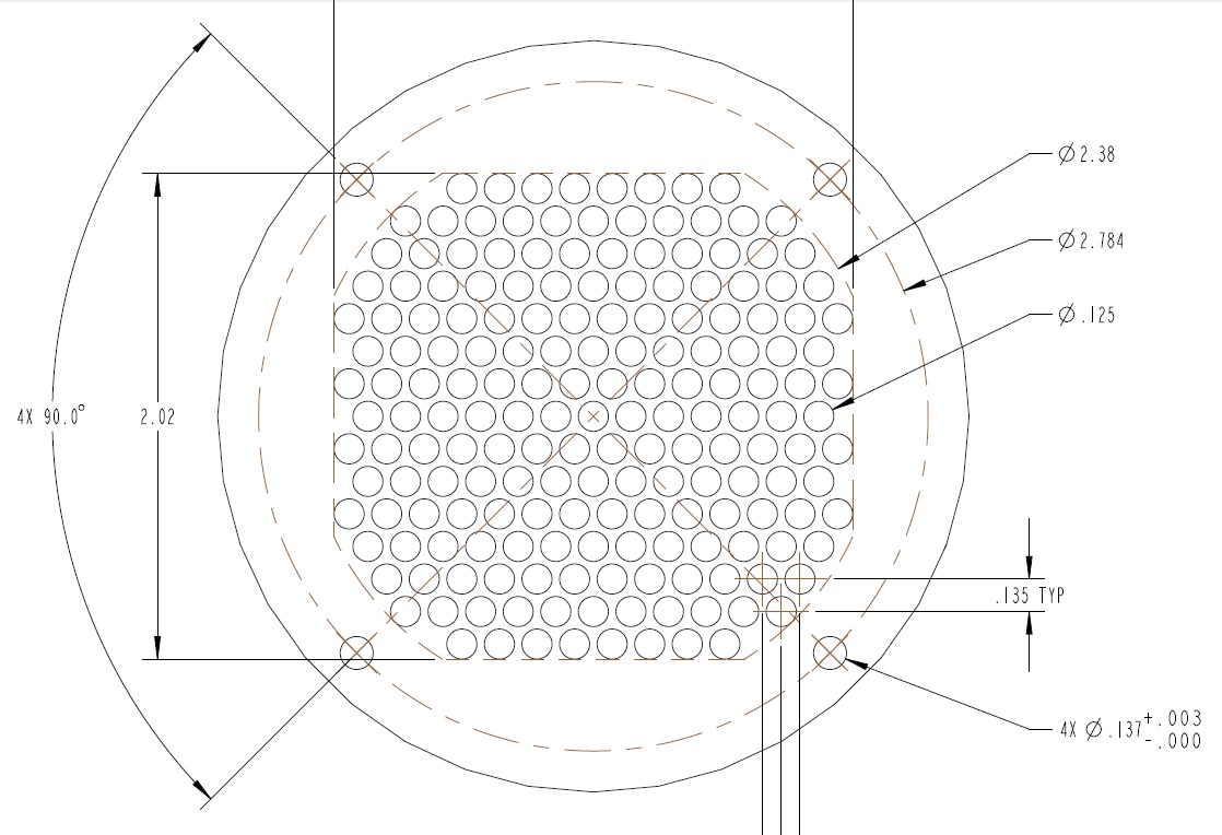

When creating a drawing in Creo Parametric, Is there a way to display cosmetic features in a detailed view independent of the view's parent?
What I'd like to do is have a detailed view at an increased view-scale with a cosmetic drawing in it that is not shown in the detailed view's parent view. Is this possible?

June 11, 2014
This sounds like a nice solution. Although I am not sure that I could achieve my desired sketch with datum curves. Please see the attached image for the shape I am trying to create.

June 11, 2014
I believe the best solution I have found thus far is to sketch draft entities using the edge feature, then relate them to the detailed view, and then erase the cosmetic features in the parent view. The dimensions for the draft entities can even refer to the original cosmetic sketch thereby eliminating any confusions regarding scaling.
This route additionally maintains the proper number and reference of views in the bookmarks when I create a pdf drawing.
June 11, 2014
I tried (Sketch|project) use edge and it wouldn't pick up the curved cosmetic thread. Not sure why. But this morning, it worked fine. Go figure. Yes, I like this solution better.
