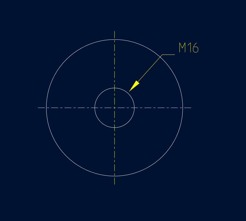

I am having issues trying to display cosmetic threads created from the standard "hole" modelling option in CREO 2.0.
Here are some screens to show my problem more clearly.
I have created a test part 50mm in diameter with an M16 hole through the center
Now, on the drawing If I shows a view on the front surface (no section) I would expect there to be the thread displayed with the hole. As you can see this is not the case:
What is interesting is that the auto generated dimension for the thread size points to the cosmetic (in this case it is seen to be pointing to nothing)
Can anyone help with this? I have played around with the thread_standard option and I am not having any joy there.

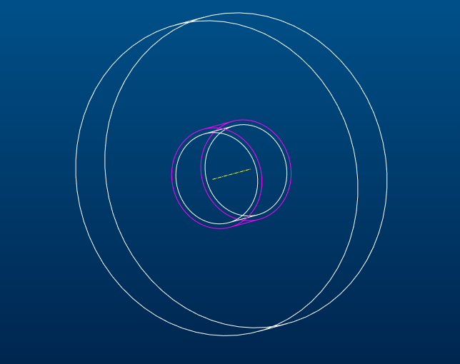

Joe,
in my Creo Parametric 2.0 M070 I can see the following drawing view.
I attached testing.dtl saved from my drawing. You can click File > Prepare > Drawing Properties > change in Detail Options row, save list of detail options from your drawing and compare them with my list.

Hi Martin,
Thanks for your help on this. I have loaded in your drawing options but still no luck - which leaves me wondering whether is is hidden in the layer tree somewhere.
any ideas?
