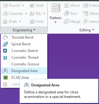

I'm working with Creo Parametric 7.0 and preparing a model for FEM meshing in Altair SimLab. I need to divide a surface on the model to isolate a specific region for mesh control. In Creo 9.0, I know there's a "Divide Surface" feature that makes this easy, but it's not available in version 7.0.
I’ve tried using the Split Surface tool, but it doesn’t allow me to sketch and limit the division to a specific area. What I need is a way to sketch a region on an existing surface and divide it so that SimLab can recognize it as a separate surface during import.

    Have you tried Designated Area under Engineering?

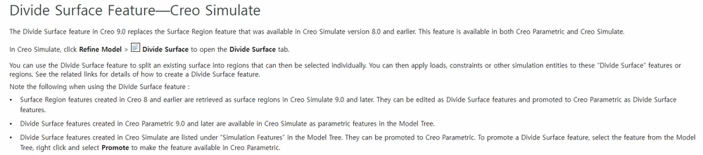

    I don't have Creo 7.0 to test, but I recall that such tool also exists in Creo Simulate?

    All ways previously suggested (Divide, Designated Area, Split in Creo9, SurfRegion in CreoSim...) are possible inside Creo, but we do not have control on how do other software behave when Creo files are imported.
