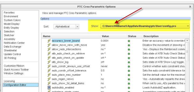

Okay, I did it. Can you tell me what I should have been looking for? I had 4 config.pro files, all made within a minute of each other. I chose the one at the top of the list, which should have been the most recent. It didn't change much, but I think it went a little bit smoother. My CPU clocked around 30% for 60sec of use but sketching a rectangle still took a patient 60seconds. I had to use the normal tool to change the dimensions because clicking on them directly seemed to not work.
StephenW
May 23, 2017
In creo, go to file, options, configuration editor. The loaded config.pro will show. Add the line that config.pro and restart creo.
