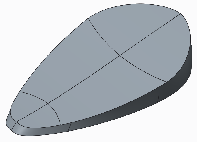

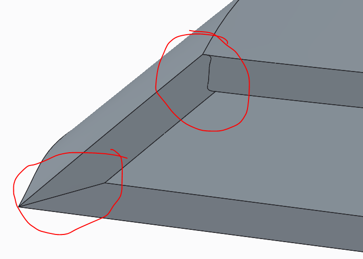

I have created a part which when halved looks fine: http://i.imgur.com/i26Qb5I.png?1, but when I try to mirror it something really screws up. This is what happens when immediately after mirroring: http://i.imgur.com/Uh4AkYB.png. This is what happens the moment I scroll in or out: http://i.imgur.com/oK2wW3H.png. I understand why the surfaces have mirrored but I don't get why the thickened walls just disappear. Does anyone have any ideas? I've uploaded the file though it's the student version so I think you can only open it if you have the student version also. (Also when I add the part to my assembly it still keeps this screwed up view).
Best answer by TomU
I just noticed something. The surfaces at the center of the model don't quite make it to the mirror plane.
If you create another datum plane slightly inside the model, cut with it (solidify), and then mirror from that plane, everything is happy.
I can't open your naitive model, but I think you may want to extend your surfaces past the mirror plane, and then either trim them off before thickening, or possibly trim the solid geometry after thickening.

Another view of before it was mirrored to show how it should look from the side: http://i.imgur.com/SyZzWnm.png

It should also be noted that you can see through the walls from all angles: Top looking down:http://i.imgur.com/qHhQd2g.png, Bottom looking up: http://i.imgur.com/7tLUWaz.png
