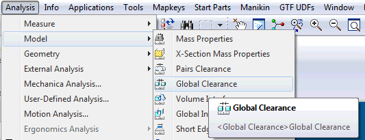

March 9, 2011
I think you are right Jonathan, planar slices only.
It may be possible to trick Pro into giving you this information by
creating two new parts in an assembly which are nothing more than one part
that has a surface copy of the inner surfaces, and one part that has a
surface copy of the outer surfaces. Then you may be able to check "Global
Clearance" between the two parts?
