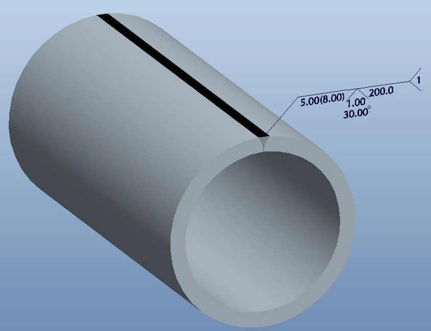

Lets say you want to weld two pieces of a part together, or an assembly of parts.
I don't see a weld feature anywhere, how do you weld things together.
thanx
Rick

Never mind I found a link, looks like it's a separate module, and shows up when there is an assembly open.
I guess you can't weld in part mode.

I see this is an old entry, but just for the record, in Wildfire 5 you can create weld features in PART mode. I attached a screen snapshot of a simple example of a v-groove weld on a tube. That was a new function that was added in WF5.

This datasheet gives you an overview of the functionality included in each Pro/ENGINEER package: http://www.ptc.com/WCMS/files/46130/en/5437_ProE_Bro_EN.pdf
Weld modeling and documentation is included in Pro/ENGINEER Wildfire 5.0 Foundation XE.

open the assembly with the components to welded together, application/welding

you can weld a part (as seams on a sheetmetal part).  It simply needs to be added to an assembly
