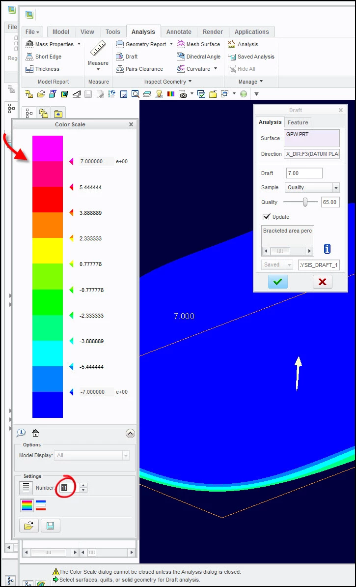

I am using Creo 2.0. Whenever I call up a saved draft check on my part, 2 things happen: firstly, the color scale window flashes quickly then disappears under the active window. I have to drag my active window to one side to bring it to the top. (And I have to bring it to the top because...) Secondly the draft display setting goes back to the default 5 colors, even though I've saved the scheme and I've saved the analysis. I don't want 5 colors in my draft analysis - it's not precise enough.
Does anyone know of a config.pro setting that keeps the color scale window to the top, or one that sets the number of colors to the amount I want? Even a config.sup or some setting in the install directory? I sometimes pull up a draft check dozens of times a day. I don't want to have to faff around like an amateur every time I call it up. This never happened in Wildfire or in earlier versions of Pro that I can remember.

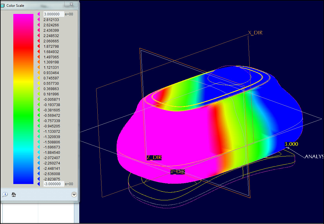

I have M040 too, so it may be as you say, the graphics driver. Although... when I try out 5.0/Creo Elements the colors stay the same, but the number of color increments goes crazy. Then when I double-click on it when the draft is not in display, then it goes back to 5 colors. I love it when computers do random crap that seems to have no logic. 5-9-2013+2-12-03+PM.jpg
