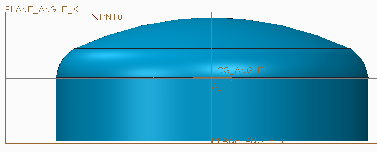

I'm looking for a solution to do this in Creo Parametric 2.0, it's to measure an angle I need to create another part.
I don't care the angle can be defined the sketcher environment or as a measurement feature, the most important thing is to get this angle.
The point is on a surface through the center of the revolved surface. The surface can be hemispherical, ellipsoidal or torispherical. (it's a pressure vessel head).
Thanks!
Jeroen.

I'm a little bit closer now.
The point you created is defined as being on a distance normal to the surface.
By doing this, it is possible to 'revert' this action and draw an axis normal to this surface.
But...
The point I need to create is created with no reference to the surface.
It is on a datum plane (DTM3), and offsetted from DTM1 and DTM2.
Is it possible to create the normal axis like this?

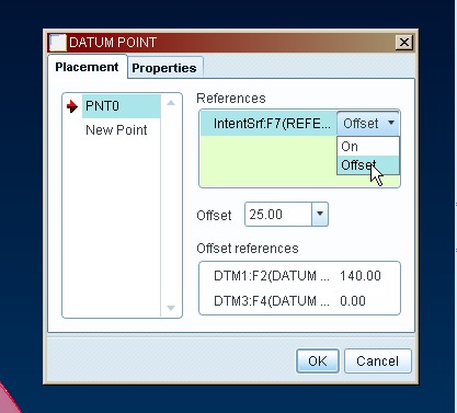

November 19, 2013
Hopefully the attached screen shot will explain, have you created the intent surface first? You also need to click the "on" to change it to "offset", (see screen shot).
