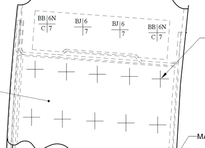

Hey guys,
please help. I need to have a drawing with a fastener pattern call out. Something like this.
We do not have time to detail holes in parts and fasteners though. I only have a sketch with the holes locations in the part (to make sure we are not having any interferances and plenty of edge margin).
Is there a way to just show the crosses in the locations driven from the sketch?
Thank you so much for your help.

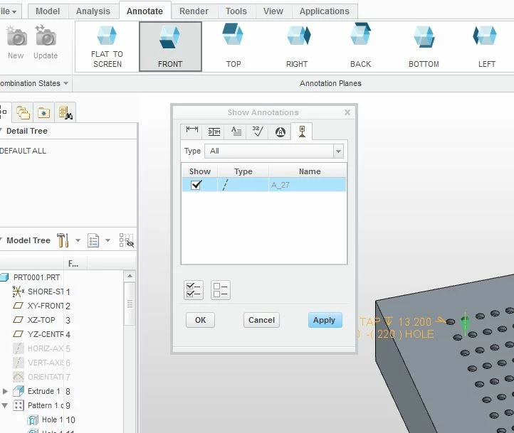

see attached

wfalco16-PearlAnswer
November 28, 2017
In drawing: annotate(top tab)>show model annotations(left lower tab)>show model datums (right top tab)>type(pulldown):axis>select part
Not sure what you mean by attaching cl to hole?
