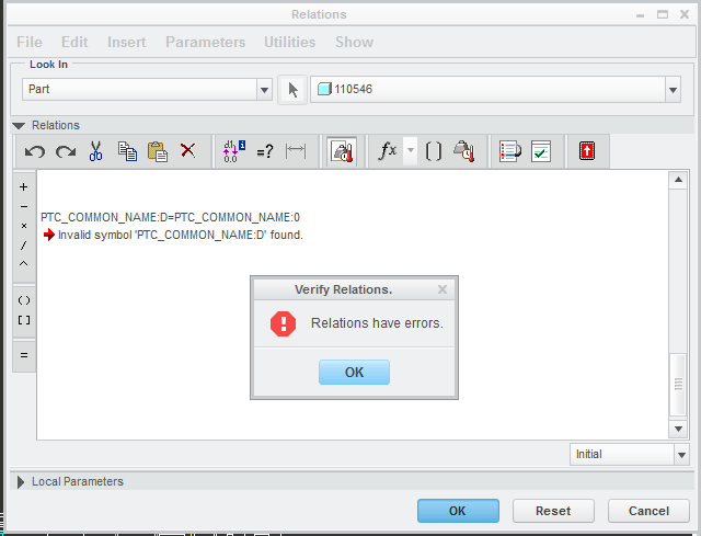

John, are you referring to creation or rename (as the picture shows)?
For the initial creation R&D has confirmed that there is no functionality to do it.
I found this, because there has been an interesting idea from a customer, using a drawing relation:
PTC_COMMON_NAME:D=PTC_COMMON_NAME:0.
However, of course it worked only for the first part in session, as the ":0" is a session ID.
In this context R&D confirmed that there is no alternate method available.
As for rename, I see no way to do it either.

Thanks for reply Gunter,
Unfortunately this relation is not being accepted in my drawing but listing errors instead.Error+Relations.PNG
It appears to be referring to the part relations, is there a seperate area for drawing relations.
John
gkoch2-ExplorerAnswer
2-Explorer
September 8, 2014
Yes, there is and it is seldom used:
Drawing relations can be added under Tools > Drawing Program in Creo, but this is a very old functionality (unchanged for almost 20 years) with a display window and line editing by menu manager commands.
