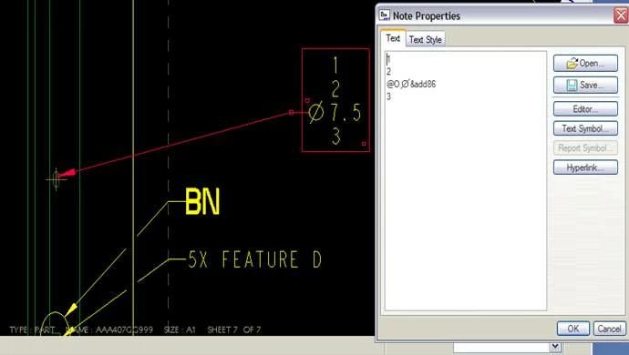

I have a diameter dimension with several lines of PREFIX text, so the leader line comes off the third line. I believe there is a "code" that I can put into the dimension text to dictate which line the leader comes off, but I can't remember it nor find it... Help???
Thanks...

Lots of suggestions for "@o"... but that doesn't "play well" IF you still want the real dimension to show up; in other words if you still have, and want, the "@D" in there...
I could have sworn I've done this before with some other "code"... hmmmm....

From Olaf Corten's site
Using the @ character in Notes and Dimensions
When creating a note or modifying dimension text you can use the @ character for several purposes:
BEGIN
TEXT
END
Enclose text in a box
Superscript text
Subscript text
@o
Attach placeholder of multiple line leader note to this line
@D
Dimension displayed as a numeric value
@S
Dimension displayed as a symbolic value
@O
Don't Display Dimension

The @o is twofold… in a multiline it will work as the leader attachment, but in a dimension it will act as an override of the text.
One solution (although not ideal) is to create it as a multiline note that is calling the dimension. I used this example with a drawing dim, but you can do it with a model dim as well.
August 9, 2011
Try @O in a created dimension, that'd match the models dimension...
