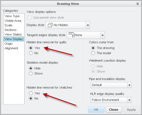

Why do these edges display in my drawing view? They are behind another solid, and my display is set to "no hidden".

Are they surfaces (quilts)? And is your drawing view a x-section?
Curt1-VisitorAuthor
May 21, 2015
It is a top view of a sheetmetal assembly. I tried the hidden line removal for quilts but that did not work.

StephenW
May 21, 2015
If it's not a x-section but try hidden line removal for Quilts in the view properties box.

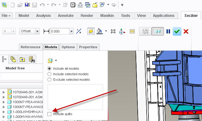

If it's a surface model and a x-section, you will also need to flip hidden line removal for xhatches and edit your x-section in the model to include quilts.
