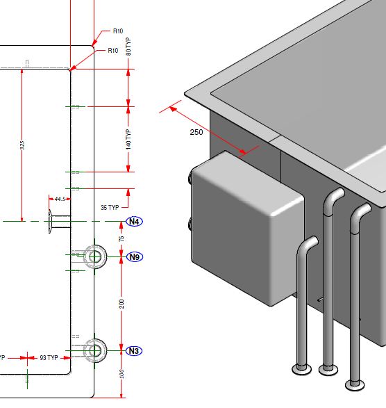

Hi, I have recently been working with a company which use Inventor. They sent me across some drawings which were cosmetically superior (in my opinion of course) to mine. I would like to try and make mine a bit more like theirs. Below is a screen capture of what I'm talking about.
First up... how would I change my dimension leaders to red? I have tried editing my pen table file (pen 2 I believe?) but the colour doesn't change. Is there another way of achieving this?
Secondly, and I have requested this feature for years. I like the black lining around the shaded part, in drawing as well as in modelling mode. SolidWorks also does this. I think it makes it easier to see and visualise certain geometry.
Any feedback, comments or opinions?

Hi Lee,
Double clicking on the dimension (or right click -properties in tree browser) will pop up one dialog which will give you option to change the text/leader color.
I dont think ( as per my knowledge) there is option to set black lining around the shaded part for drawing and for modelling.

Hi, thanks for the response.
Changing the colour in this way also changes the text to red, something I did not want to do. Also it is not very practical to do that every time I create a drawing. Can I assume there is an option in the config.pro for this? I would ideally like to change only the leader though and leave the text as it is. Anyone else have any suggestions?
Regarding the black outline, I think you are right, its not possible as I looked in to it a while ago.

To print yellow witness lines in red colour, you can use the following pen definition
pen 4 color 1.0 0.0 0.0; thickness 0.01 cm; letter_color
To display part with coloured edges, you can use the following procedure:
set config.pro option option ... show_shaded_edges yes
assign black colour to whole part
assign grey colour to all part surfaces
Martin

To have only red leaders on a screen drawing, in your Drawing Options file set
LINE_STYLE_STANDARD to std_iso
(this allows you to have different text and leader line styles)
Go to View>Display Settings>System Colors
Leader Color is controlled by Letter Color, so change it to RED
Text Color is controlled by High-Light Edge
Refresh the drawing.
The colors you get in the print are controlled by the *.pnt file - you will need to adjust them in that file if you want a colored print.
Heres a list of the various System Colors and the related drawing entity - whoever programmed this up was on planetPTC when they coded it - theres no rhyme or reason to any of it. Its taken hours to untangle the mess - hopefully its of some use to you. This had better not turn up in the new CREO.

Hi thanks for the information. However, I do not find the LINE_STYLE_STANDARD option in the drawings option file. I added it manually but it doesn't appear to do anything. I changed Leter color to red, this changes leader lines and text to red. I changed High-light edge to black but nothing happens. The text stays red. I'm guess this is what the LINE_STYLE_STANDARD configuration option is for but it doesn't seem to work for me? (using WF5).

LINE_STYLE_STANDARD doesnt appear because youre using your standard drawing options file and it doesnt contain it. When you open an old drawing you need to refresh it so the new Drawing Options file gets used - otherwise it just uses the imbedded old options. This works in WF4 and WF5.
To refresh go Update Current Sheet(s)
