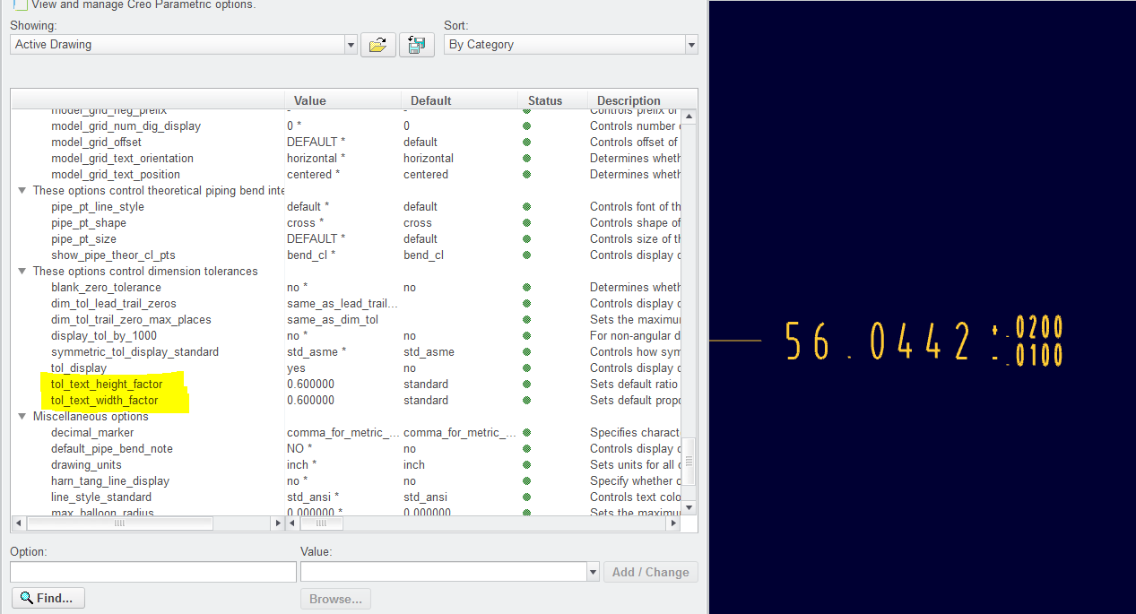

Can anyone help me to change the font size of just the super and subscripts of a drawing dimension? I have drawing (dwg1) that I want to look like and old drawing (dwg2). I can change the overal height and thickness of the dimension, but not just the super and subscripts. Thanks in advance.
Best answer by TomD.inPDX
Unfortunately this is one of the ISO introductions. It is quite prevelent in the Euro drawings.
It is controlled in the drawing's *.dtl file and also in the model's detail options.
Model: File>Prepare>Model Properties>Detail Options
Drawing: File>Prepare>Drawing Properties>Detail Options

I couldn't find it within PTC help, but it looks like it's been there for a while, hidden away.
tol_text_height_factor STANDARD
tol_text_width_factor STANDARD
Who knew the text STANDARD would accept a numeric value?
