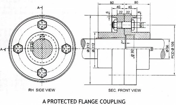

I have a question about section view in Creo Parametric 3.0. I'd like to create section in which some elements (like screws and nuts) are full-visible. E.g. look at the picture below, please.
There's flange coupling where right view is a section but elements like shaft and screw with nut are not hatched. Could you tell me how can I achieve that in Creo 3.0 Drawing?

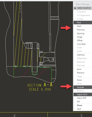

In the drawing view, select the x-hatch and RMB - Properties (or double click the x-hatch).
Use NEXT or PREVIOUS to highlight the component you want to modify the x-hatch on.
Select EXCLUDE for the items you do not want to be sectioned (warning - view doesn't really update until you complete the operation).
Once you get all the items excluded, select DONE to complete the operation, view will update.

I've never thought something could be such simple in Creo.. Thank you so much, sir, that really helped!
