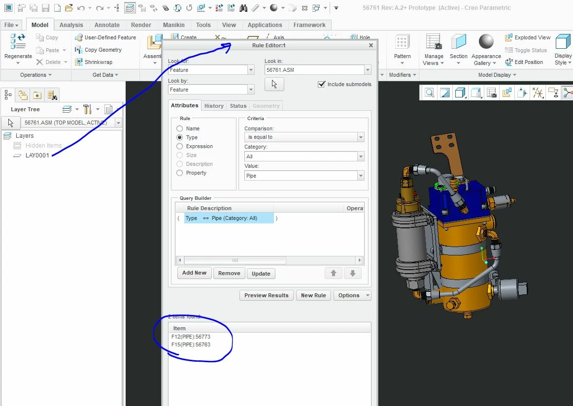

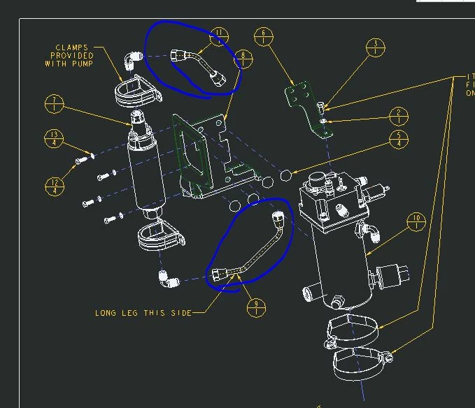

I have an assembly that has two fuel lines made using the pipe feature. (Creo 3.0m150/WC10.2)
I am attempting to make a layer with a rule to collect the pipe centerlines and make it easy to hide them in the assembly drawing. Theyu ;ayer is in the top level assembly. The rule will find the features in the rule editor, but once I hit OK it's a no go. If I go back to the rule editor it can no longer find the feature. The options are set to associative, rule enabled, and independant. What am I doing wrong?
