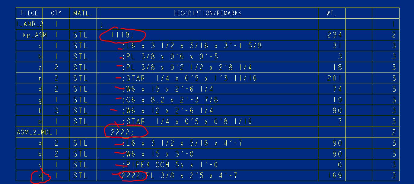

drawing number in repeat region
  • July 29, 2013
  • 1627 views
does anyone know how to get the drawing number (in this example) "1119" and "2222" to show up on this bom for each line? i cant seem to figure out how to get the drawing number to show up except in the case of pc 'd' on the bottom; where I added the parameter at the part level. in this example i would like to have only drawing level relations controling the "drawingno" parameter i have made.

I'm not sure I totally understand what you're trying to do... but from what I gather, you want to append the assembly name to the part description. So for each part, you want some of the part parameters to show in the table but you'd also like to see what assembly that part "lives in". This is usually not possible. Each line of the repeat region is pulling information from one and only one object ("object" meaning part or assembly model). You can't pull information from two objects in the same line and you also cannot combine data from different objects.
For example, you could not grab the description of one object and combine it with the description of another. This goes for all parameters in a model. The only exception is when using a summation to add values between rows.
The old "Pro/REPORT" upon which the repeat regions are based was archaic and useless when it was introduced 20 years ago. In my personal opinion, it's inexcusably worthless today. Normally I wouldn't be so blunt but I'm too worn down to be too politically correct right now. Excel circa 1998 has more features than Pro/REPORT does because you do have the option of referencing other cells. In your repeat region, you're forced to have all the information you need exist within each object.
In other words, your best bet is to add the parameter you want to each part inside your assembly. Once this is done, it's easy to show the parameter as part of your description. Other ideas come to mind but none of them are very good:
