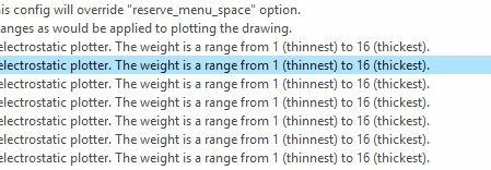

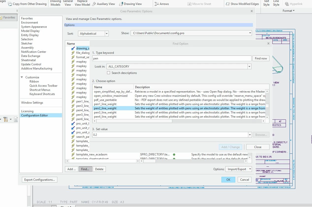

As I am a creo user, I facing a problem with Pen line weight. My drawing units are in MM. But I am unable to set line weight in a decimal place like 0.5 or 0.19 like Auto Cad. What I am getting that dimension line and center line and another reference lines are coming with the same thickness. I have attached the one screenshot of the same. Kindly suggest me how I can set thickness os all lines while working in MM units

    You'll want to set up a pen table file.
    See these posts:
    https://community.ptc.com/t5/Data-Exchange/Separate-Pen-Tables-Used-for-PDF-s-and-Plot-Files/m-p/536254
    https://community.ptc.com/t5/Data-Exchange/PDF-Thickness-Pen-Table/m-p/398264
    There are many other posts discussing this, use the search term pen table

    Thanks, Stephen Williams but the problem is of the decimal place. Kindly check the attachment
    July 12, 2018
    Read the second link again. It describes how to use a pen table and how to set pen widths with a unit designation (only IN and CM are allowed). There's also a link to the Creo help page on pen tables.
