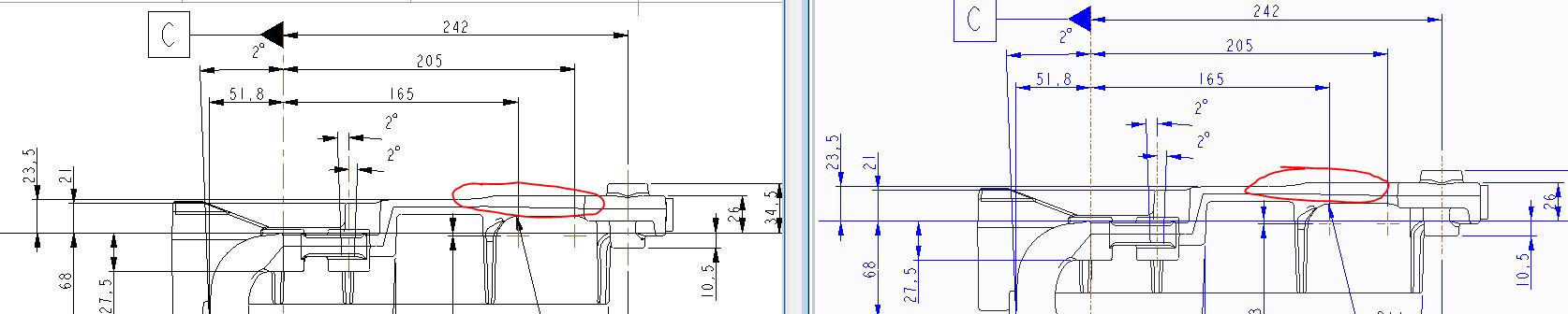

Dear Experts,
I need your help to fix this burning issue
Most of the drawings look good when we open it from Creo2.0 parametric, even the quality of export to PDF from parametric looks good,
However when I open the same drawing in creo view 2.0 it looks horrible despite the fact that I had set an environment variable PVIEW_PRINT_MINIMUM_LINE_WIDTH with value as 0.2
Can any one help me out on this
Thanks in advance,
Athmanand

Here is what I found when comparing pdf's from native creo and creo view.     Creo displays Vector, and Creo View ( through our cad worker ) displays Raster.
IMO, this is a backwards step from PTC, since previously Product View was capable of producing Vector displays.  No matter what settings I modify, we'll never be able to produce as accurate file from creo view when compared to Creo.   With a large number of customer manuals, this is not acceptable.  Therefore we spend more time and licenses using Creo.

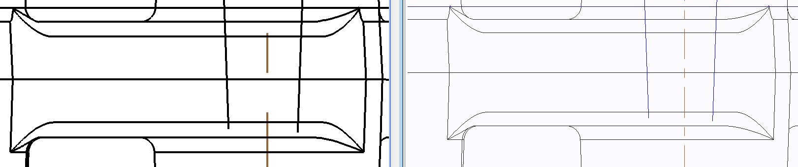

I have two images below comparing View to Parametric(zoomed out and zoomed in) from a drawing in our system.  From my perspective, I would call the quality good but that is just my opinion.  The picture is from CV3 Client and worker at CV3 adapters with Creo Parametric 2. Is the bottom left picture your definition of not good?

I found PTC support article CS219661.
Set environment variable PVIEW_PRINTING_REGION_DISABLE = 1
My users were experiencing exactly the symptoms as described in the article.  They noticed the difference in PDF generation from Creo View immediately after implementing the solution.  It is a user environment variable, so it can be added to a startup script, or added manually without the need for admin rights.
