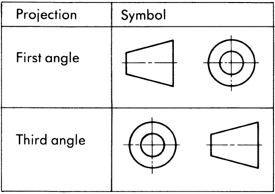

don´t use sketches in drawing to describe/draw something. Part is a owner of all informations and drawing is derived from part.
Good place to use sketches are drawing formats. For examle for a projection symbol. projection_symbols.png
l have never used sketches in drawing, only inside format files.
Regards Milan
