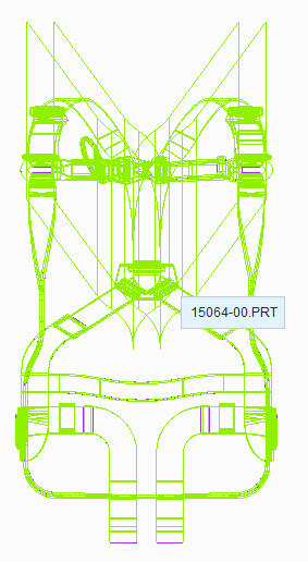

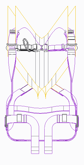

Has anybody seen the following before, please? I have a harness that renders well in the part and assembly but in the assembly drawing the splines cannot be handled. The image on the left shows the incorrect render in the drawing; the image in the middle shows the harness being hovered over so that the correct profile is visible (although the errant splines also still show); the image on the right is the harness in the assembly. All are displayed as "No hidden". Any ideas on what config settings or drawing sensitivity settings might be able to rectify this, please?

Nudge. Any ideas, please? I've tried changing the angle of the view by 5º but it does not solve it.

No hidden mode in assembly drawings has difficulty with interferences.  Can you run an interference check or try suppressing some of the models?  (These look like surfaces, so not sure if this will apply.)
