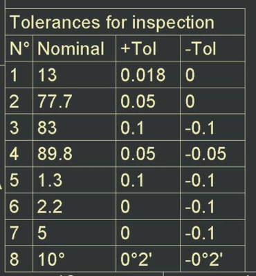

I am looking for a way to add a drawing table with specific dimensions for which we request inspection. I have manually made this table :
I am looking for a way to automatically fill this table : the idea would be to refer the dimensions that need to be inspected somewere and that it fills the table and extract the minimum tolerance and maximum tolerance. Also it would be great if this table would update as the dimension or tolerances are updated.
Is there a way to do that with Creo maybe with a drawing table, parameters and a repeat region ?

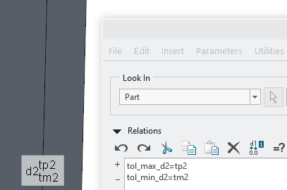

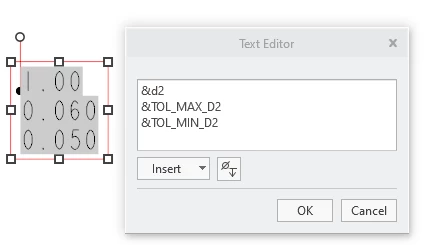

The only way to do this that I am aware of is a round about away. You can copy the tolerance into a parameter and then show that parameter on the drawing:
