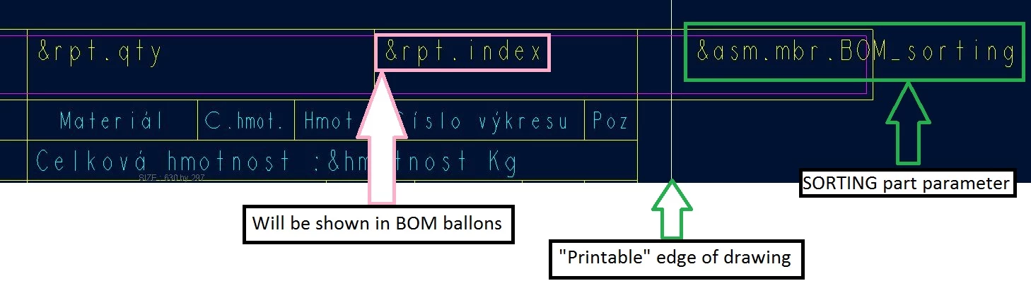

Hello @pete3000
 l will desribe you my praxis around sorting components in repeat region. See following picture:
BOM_sorting parameter located out of printable drawing space and some "numbering schema" is the magic trick. BOM_sorting parameter is included in each part and assembly. It´s only auxiliary parameter.
In result the table will be sorted by BOM_sorting descading:
- imported geometry - BOM_sorting import template value 90
- nuts - loaded from server - BOM_sorting value 70
- screws - loaded from server - BOM_sorting value 60
- sheetmetal parts - BOM_sorting from template - value 50
- solid parts - BOM_sorting from template - value 10
- assemblies - BOM_sorting from template value 1
- corner stamp -
BOM sorting:
1st rule BOM_sorting parameter
2nd rule drawing number parameter
Working progress in praxis:
- create assembly with many subassemblies, parts, screws etc.
- all assemblies are BOM_sorting value 1 - are at the bottom of table (change the value between 1 and 9 in order to rearange)
- all solid parts are BOM_sorting value 10 (are above assemblies and bellow sheetmetal parts) ordered via 2nd rule drawing number - change BOM_sorting value between 10 and 49 in order to rearange
- all sheetmetal parts .... the same like solid parts ...
- etc. etc.
Advantige of this method:
- more different components can be the same BOM_sorting value ---> &rpt.index is shown in BOM ballons and it´s unique for each part ---> each BOM ballon value will be unique
Disadvantiges of this method:
- do not use annotations like: "weld position 5 and 8 together" ---> position value can be changed without your "wisdom" (added or deleted parts) and your annotation will be confusing
Hope it can helps
Regards @mbonka
