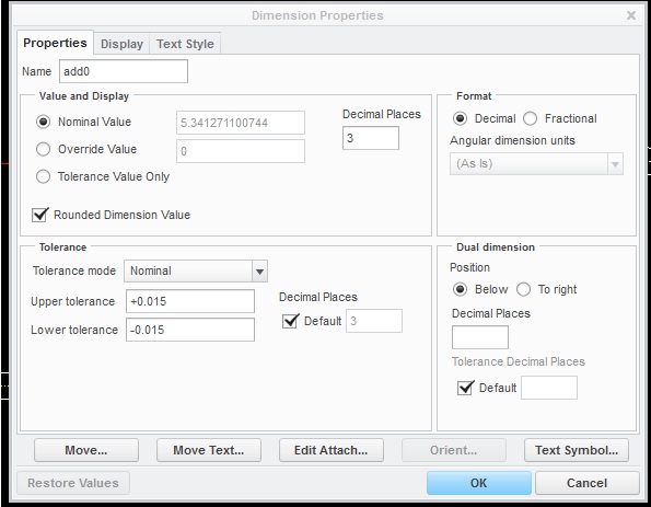

Can anybody know how to manage this problem ,as i just updated creo 2 from pro e wildfire ,it happened in all drawing sheets .
I dont have an idea of changing this decimal places.

April 11, 2014
Manish,
I have seen your problem before so this might work. Right mouse click on the dim and bring up the properties and make sure that the rounded dimension value is clicked or checked.
Rick
mgupta-41-VisitorAuthor
April 11, 2014
Rick,
Yes by clicking rounded dimension value its working,but is there in method of doing in one stroke.
Itself it is also a great help.
Thanks Rick.
Manish
April 11, 2014
In my config.pro has:
default_dec_places 6
default_ang_dec_places 2
but, when I want to work with Drawings, I add in the Drawings folder a current_session.pro with:
default_dec_places 2
default_ang_dec_places 1
and in the Options I will import this file to chage the defaults values of the config.pro.
