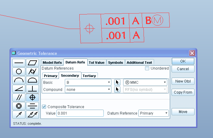

And since I am having so much trouble transporting the model GD&T from the model (crashing and corrupt drawing files), another limitation presented itself in making composite feature control frames in the drawing...
These cannot be duplicated with the text editor. Remember, I am charged with making "certified" drawings. This means it must meet the standards in -every- way.
http://communities.ptc.com/servlet/JiveServlet/downloadImage/2-185349-34533/450-292/composite.png
...image compliments of our own Brian Martin.
July 13, 2012
Ok, I was gonna suggest that you could always try to go define those tags as symbols. That alone wouldn't be too hard.
But defining every such compound geometric tol as the one shown on Brian's picture would be a huge painfull PAIN.
Still a way to go.
If you ask me I would be in AutoCAD after the two first miliseconds just thinking about this.

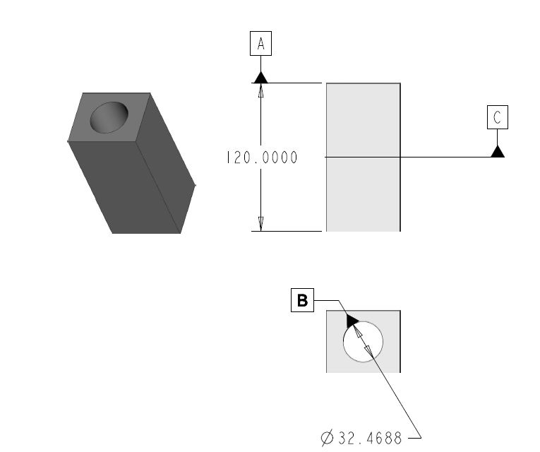

A new problem cropped up today in detailling. I had already reported this to CS but didn't have all the facts. Today it became clear there is a bug in the presentation of datum tags on drawings. It has something to do with re-associating datum tags to gtol or dims. The text will become bold as it is in the models. It soon resolves itself but for the time being, it is problematic as this does plot with the wrong font settings. This is a screencap of the PDF, stroked font PDF plot output... [B] was moved from the cylindrical surface to the dimension.
...and wouldn't you know it. I tried to move the [B] datum and it crashed all my sessions!
I think this answers my original question...
YES, CREO 2.0 DETAILING IS QUITE UNSTABLE!
