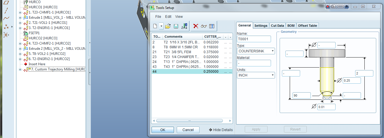

How are you milling your chamfers? I just use a custom trajectory which does allow a countersink tool to be used
August 26, 2011
That is the method that we use also.

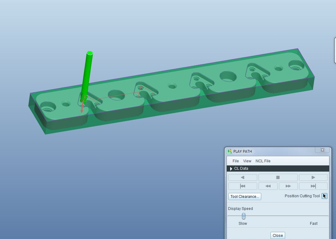

Either of you have a suggestion to get a roughing and or re-roughing to stay in the cut without jumping around like a kangaroo on steroids? We spend more time with the tool retracting and moving around to a new start location than actually making chips. Extremely frustrating for both the programmers and operators.

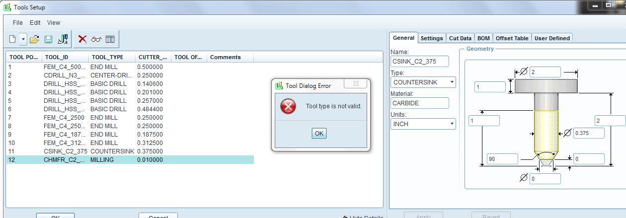

again you are correct you can chamfer with a countersink but you cannot countersink with a chamfer tool so I guess I need to change how I do my chamfering
August 26, 2011
Are you running WF5 M100? It lets me pick that tool type for custom trajectory.
August 26, 2011
Yes Nick WF5 M100
what I was saying is that I can use custom trajectory with a countersink but you cannot countersink a hole with a chamfer tool. it gives you the tool type not valid error message. Sorry for the confusion. it doesn't matter since you just showed me I can use a countersink for chamfering.

Nick posted a side milling example on here a while ago. It works great. I use it when ever I can. it works like trochoidal milling.
