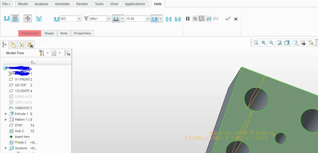

Hi, Use engineered holes they have all the sizes you need with drill points, counter bores and countersunk. You also get for free the hole notes that can be customised in format to keep notation common in your design group.
Holes is under the model tab, engineering. Pull down to reveal holes.
