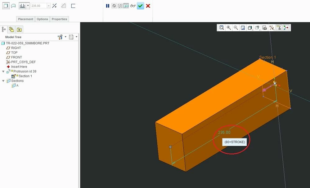

I have a dimension which is driven by other parameter, but could not find where is the parameter come from.
Thanks in advance.
2-Explorer
July 19, 2017
Check into Relation (Tools-->Relations).
kdirth
July 24, 2017
Relation could be at the part level or the sketch level.  I would guess, based on the name, it is at the part level.  To see it at the part level you have to be out of the sketch and extrude feature.  To see it at the sketch level you have to be in sketch and switch tabs.
