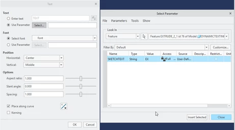

I tested a few methods to see if this possible and at this point in time, I'm not sure it is. The key would be to drive the sketch associated with each extrude by a parameter. It's easy to drive sketch text by a parameter, it's not so easy to make the parameter vary based on the pattern ID of a feature.
Based on this article, I don't believe it's possible to harvest a feature name and use it to populate a parameter.
Display features names as a parameter
With that in mind, I went a different route and attempted to append "EX" to the pattern instance (number) converted to a string. This is still a challenge because each sketch has to be driven by a unique feature parameter and I can't find a way to get the instance ID.
So, the relations that you put in the first instance of the pattern have to vary a single parameter (inside the first instance) in every other pattern instance. This isn't possible. It's also worth noting that it seems to matter what kind of pattern you're using. Creating a unique feature parameter in every pattern instance to call in each sketch isn't viable. It would take more time than it's worth.
