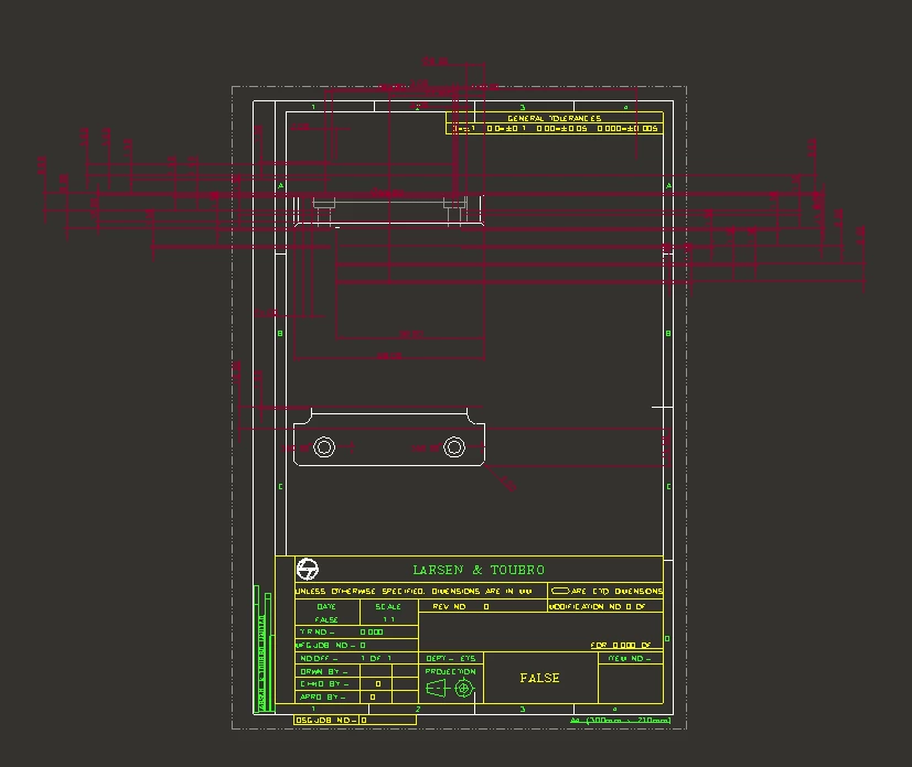

I am trying to create a drawing template which has got multiple sheets in it and each sheet has a different size/format. Also i need to specify the views in all the sheets along with the dimensions, hole chart & bom.
Is it possible to do that for multiple sheets in just 1 template?
Also i want only some dimensions in the drawing, is there a way to control it?
