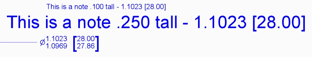

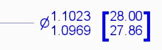

A while back I converted everything over to use PTC's new Arial WGL TrueType font.  Some of my users are very unhappy with the change.  They don't like how the TrueType fonts make everything look bold compared to the old line fonts, especially the brackets in dual dimensions.
Does anyone have any suggestions on how to make the (automatically created) dual dimension brackets not look so bold while still using TrueType fonts?  There are some distinct benefits that come with TrueType fonts and I'd prefer to not lose those just for these brackets.  Thanks.
TomU23-Emerald IVAuthor
January 18, 2019
So I figured out why the brackets look bold.  The font for the brackets is 2.5 times larger and therefore 2.5 times thicker than the characters they're surrounding.
It would be nice if there were actual characters for double height brackets instead of increasing the text height of the single height characters to make them the height of two rows.

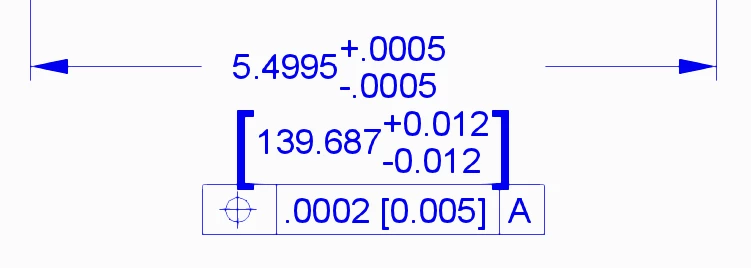

This actually gets worse.  The brackets overlap the GD&T feature control frames too.
Tech support claims this is 'working to spec.' and to create a product idea.  I'm pushing back...
Dale_Rosema
February 27, 2019
That doesn't look like it is working to spec, unless those are Coke bottle "specs".
February 27, 2019
Remember, 'working to spec.' doesn't mean it works in a way most people would expect it to, rather there is nothing in the spec. that says it shouldn't work this way.  Huge difference!
Since there is nothing in the spec. that says the brackets can't be extra bold and overlap other stuff, it's effectively 'working to spec.'!  Ugh.
