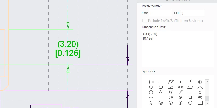

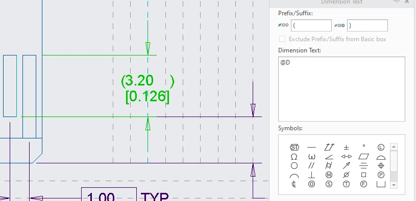

I'm trying to find a way to keep a reference dimensions looking like (3.20) instead of (3.20    ) when I use dual dimensions. The only fix I've found so far is to manually override the dimension, but that's a pretty terrible solution. There should exist a way to prevent this formatting error through the software setting.
Photo attached below to show what I'm talking about.
Any advice on this is welcome!

Jan 16, 2020 7:08 AM UTC
I suggest you to report the problem to PTC Support.
From my point of view the problem is related to drawing option dual_dimension_brackets.
1.]
If drawing option dual_dimension_brackets yes is set then extra space is displayed before right parenthesis in primary value. This is because right parenthesis is placed after right bracket displayed in secondary value.
2.]
If drawing option dual_dimension_brackets no is set then brackets are not displayed in secondary value and right parenthesis is placed correctly.
