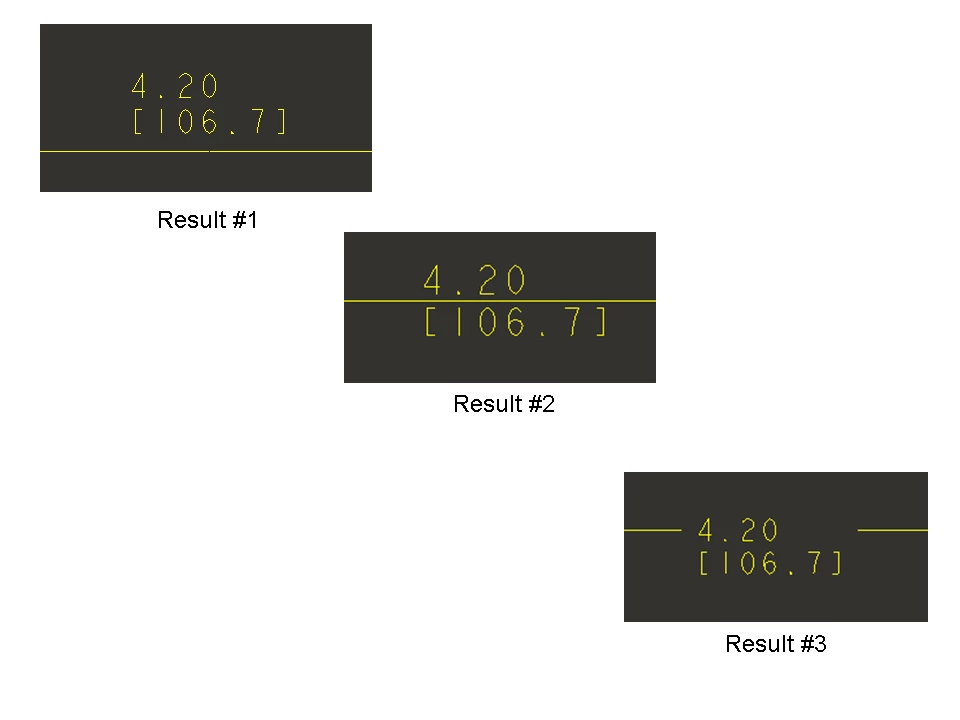

Hello all,
i am producing a set of drawings that need to be dual dimensioned, primary units mm, secondary units inches. It is my first time having to do this & i think i have most things figured out, but i cannot display the dimensions how i would like. At the moment i have primary units on top & secondary units (in brackets) below, but both above the leader line. How do i get the dimension to show primary above the leader line & secondary below the leader line, i'm sure this is probably a config option, but i am unable to locate.
Regards
John

Hi John...
I'm sure none of these will be quite what you're after but here's the best we've got. All of the options you need to toggle are in the drawing options file, not config.pro
To modify these options, go to File>Drawing Options when in drawing mode. The settings used to achieve each picture are listed. For all examples ENGLISH is set to be primary and METRIC is secondary.
Settings #1:
dual_dimensioning primary[secondary]
dual_secondary_units mm
lead_trail_zeros std_english
text_orientation parallel
parallel_dim_placement below
Result #1:
Settings #2:
parallel_dim_placement above
Result #2:
Settings #3:
text_orientation horizontal
Result #3:
The only way to split the dimensions is to use the text_orientation set to PARALLEL but this causes all sorts of ripple effects through your dimensions. It's perfectly acceptable from an engineering standards standpoint to dispaly dual dimensions as they appear in Result # 3. While you can certainly tweak the dimensions to look like Result # 2, I'm not sure this is precisely what you're looking for.
There is NO way to keep the "line break" yet have the dimensions split the dimension line (at least no way that I've ever seen).
Note that there's also a setting for text_orientation for "ISO_PARALLEL" which gives a slightly nicer look to the dimensions (the dimension text appears centered horizontally) but otherwise the effect is virtually the same as the other results.
Sorry I couldn't be of more help. Let me know if you get stuck.

October 3, 2011
Hi Brian,
the parallel_dim_placement (below) was the the option i was looking for. Like i said, 20 years doing the job & i have never had to dual dimension before, so this is new to me. Anyway, that option gives me what i want.
Regards
